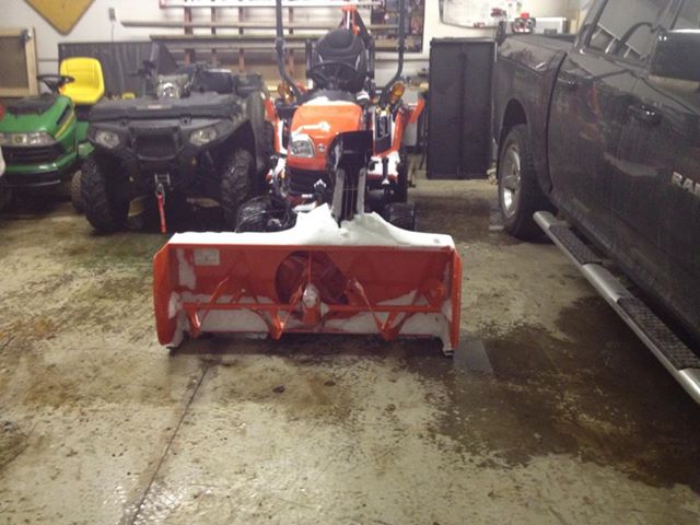

I have the BX2755HD. It is a monster! Just got to use it a couple times last week, it ripped through the snow like nothing. Throws the snow far, the hydraulic chute rotation is quick and snappy. The cost was a lot with the quick attach, drive shaft and blower it was a hefty price tag of 4500. Worth every penny though. Going from plowing my obscenely long driveway with an ATV to this is simply blissful. The whole thing is heavy duty, all steel construction, easy removal and installation. Hope this helps.
blower.jpg !!

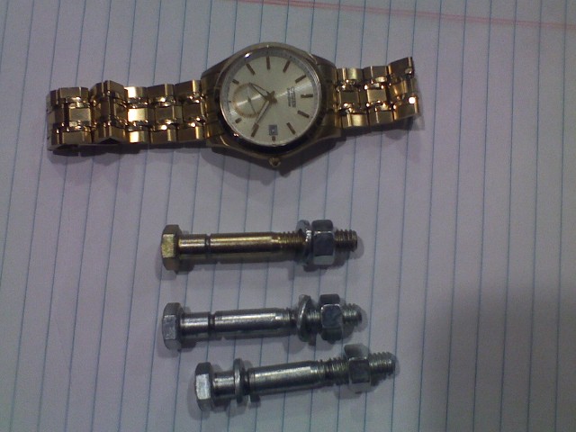

By the looks of some other threads, get yourself some shear bolts, just in case. It should come with a set of 3 (2 soft (silver) ones for the auger, and 1 harder (gold) for the fan).
I've used mine ~1 hour on a stone driveway, lawn, etc., without an issue, but some guys are going through several. Maybe the BX2750D has cured some of those issues? Don't know, but I got 4 of each today because of the storm coming.
