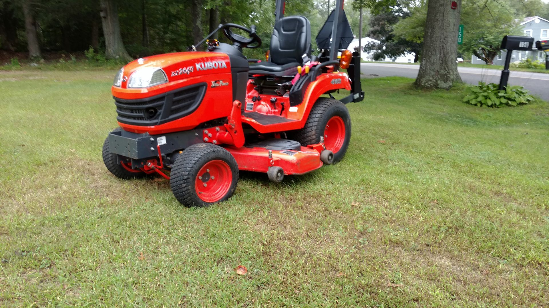

Thanks for the video link! I followed that video and remove my FEL for the 1st time ever today! I've had the tractor since March and put 75 hrs on it since then... Took 5 minutes
Looks naked without it, but will be a bit easier to mow with now!
