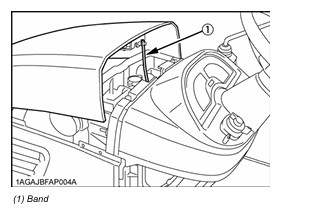

Put the plastic band on the latch pin, it holds the hood in the correct spot to slide in the hood under cover.

You mean the “KNOBS” with the plastic heads won’t turn? My older Bx has these. Hood removal is easy but sometimes a pain to re-align when putting it back on…

Mine is a 2012 as well…metal hood and fenders, etc.
has 2 plastic “knobs” that you unscrew to loosen the hood to slide it forward. Just a slotted section of the hood that fits beneath the knobs. Pictures of yours would certainly help!
