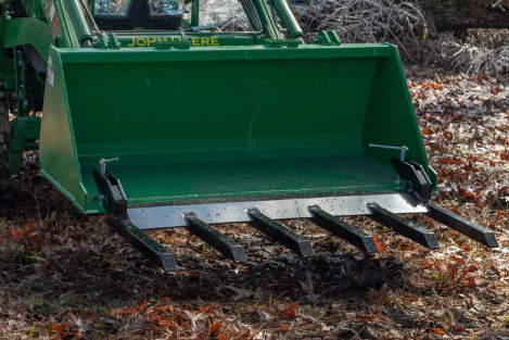

Something to keep in mind when buying these clamp-on forks.....
My neighbor borrowed mine & liked them so much he that bought some for himself, but he bought some no-name ones off e-boy.
They fit, but the T-handle clamp screws were too close to the inside wall of the bucket, and he had to shorten the "T" handles to clear.
That meant he couldn't get them real tight by hand, and they shifted while using them.
Now he uses a short pipe or a hammer to get them tight.
Not a deal breaker, but something to think about.
I replaced the T-handle clamps on mine with short hex head bolts, because the "T"s stuck up about 4 1/2" from the forks, blocking stuff on the forks from sliding back into the bucket.
The bolts only stick up about 3/4", and I already carry an open end wrench that fits another implement with me anyway, so it works well for me.
