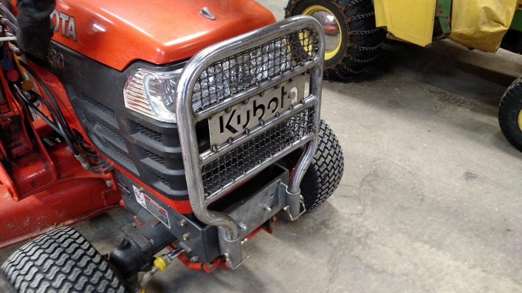

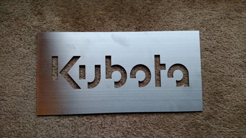

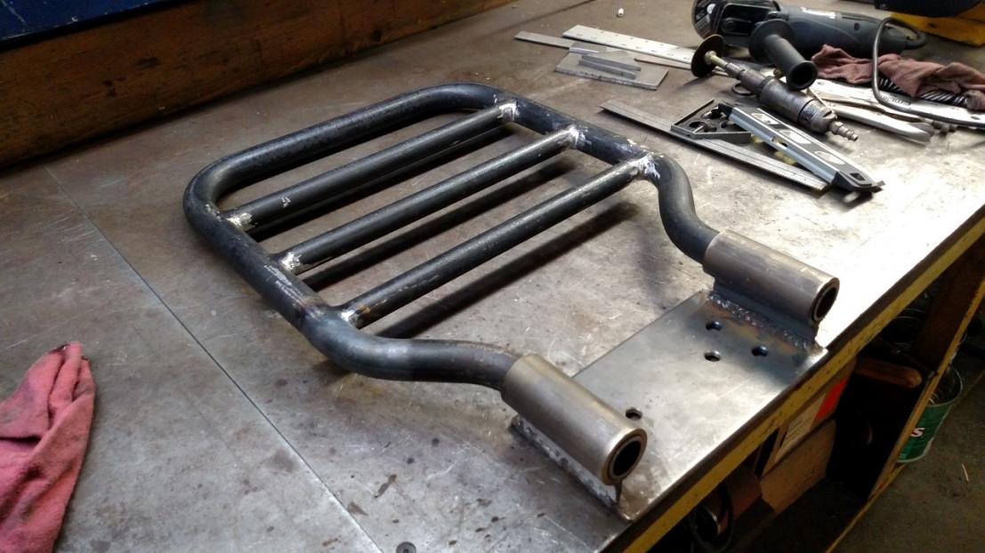

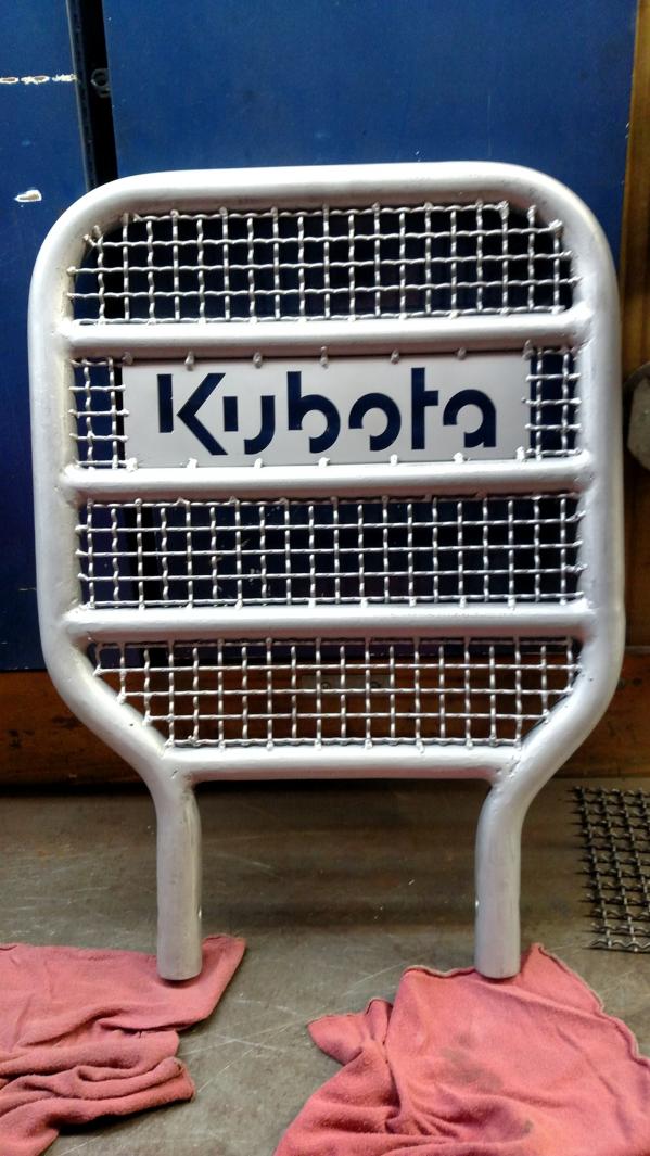

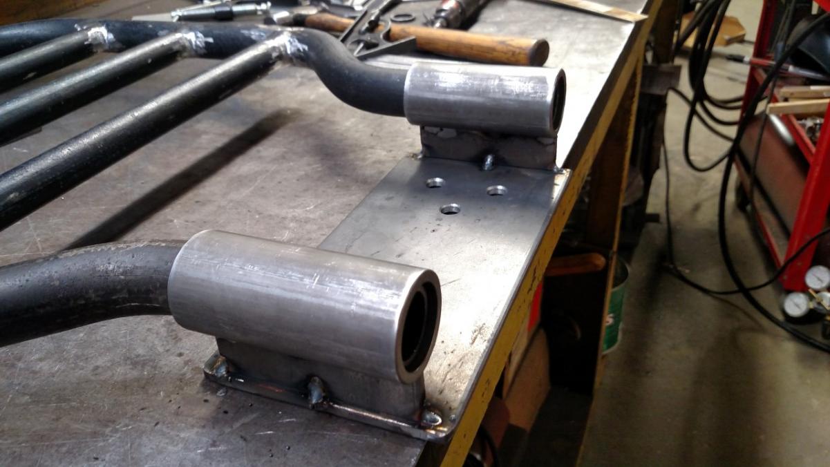

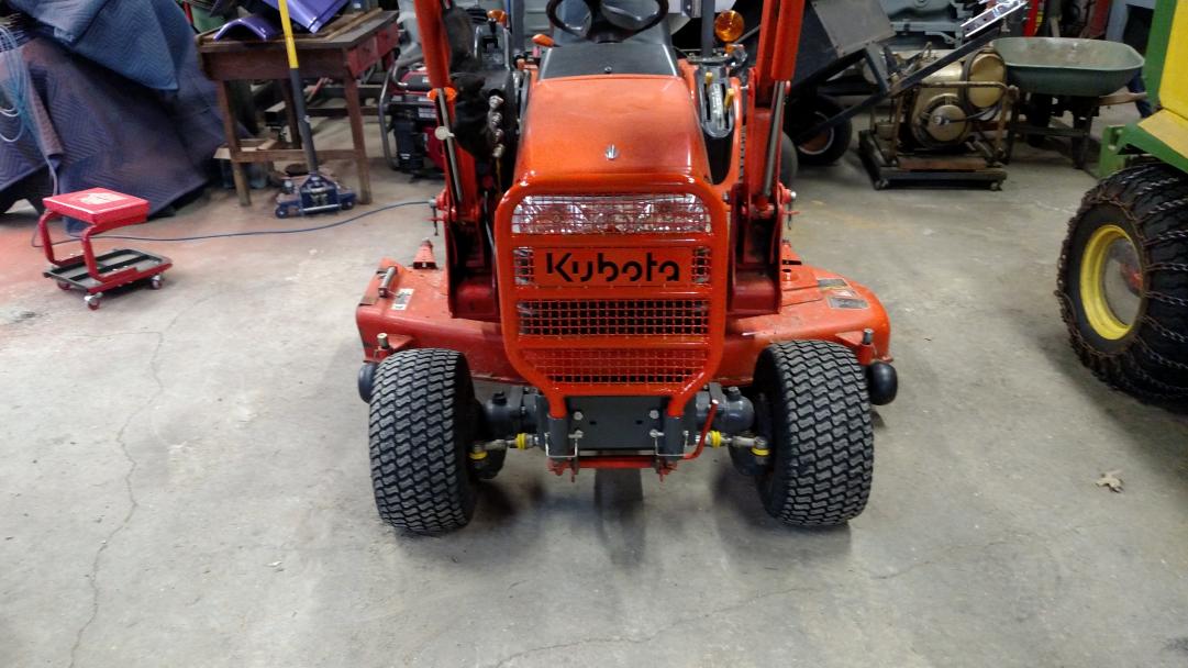

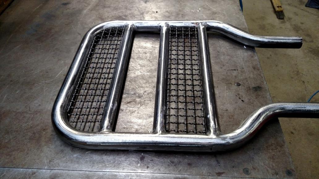

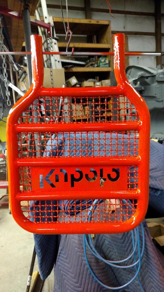

I've been slowly working on the brush guard for my BX2230 this winter. It's been so d#$m cold and my shop doesn't heat very well, so I haven't made as much progress as I would have likes to by now. But I did get everything welded together and Monday night I worked cutting some metal screen material down to fit in the upper and lower openings. I also got the Kubota logo plates back from eMachineshop.com. They did a great job of cutting the logo into the 1/8" plate. Judging from the looks and smoothness of the cuts, it must have been done with a water jet. In any case they look great.
When we get another fairly warm day, I'm going to fire up the TIG welder and weld the screen material in place. Then I need to trim the logo plates down to fit in the center area and weld them in place also.
Then I'll get the guard and the mound sand blasted and either paint it or get it powder coated if the powder coater has a color close to Kubota orange.
