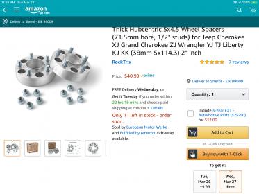

I went with 2” and found them on Amazon for a fraction of what Kubota wants for the same thing. I believe having a cab on my 2380 adds to the “tippyness” feeling of these machines. It feels much more stabile now....
Can you post a link, I cannot read the small image to get the info... ( I'm an old fart as well... )
Thanks
14,698
7,207
I think you can click your mouse on the image he posted, the it just shows that picture a bit larger. Then put you mouse on that picture, press you control ( CTRL ) on your keyboard and then scroll with your mouse to enlarge that picture.
