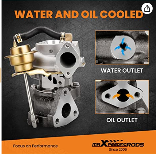

Question - how did you plumb the oil lines to the turbo?
this is a VZ21 RHB31 Turbo Charger
