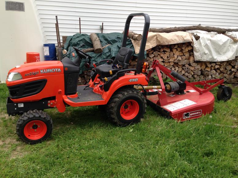

My Kubota dealer told me a 4' would be a little too large for a BX2360. The manual recommends a 42". I ended up with a 4' anyway since there are about thirty 4' cutters for sale for every 42". It handles OK with the loader on. Maybe the recommendation was with loader off.

I bought a Bush Hog Squealer 48" 2 years ago for use on my BX 2360. IMHO it has plenty of grunt for keeping our hunting property food plot fields maintained as well as 3-4 ' overgrowth. I do advise you use loader or weight the front end, as i have looked toward the sky with out any weight on front...:eek:
