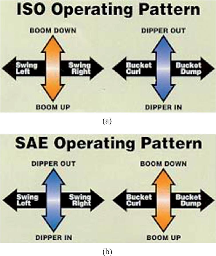

Matt, I've seen this very same image before and I can tell you that it is incorrect. It's the exact opposite.
ISO (CAT) pattern puts the stick/dipper control on the left, boom on right.
SAE (John Deere/backhoe) pattern puts the stick/dipper on the right, boom on the left.
...just sayin
...just sayin
It looked odd. I am use to JD controls myself.
It's on the internet, it has to be true!
Ha, yep. I think its pretty funny that this one shows up all the time...and its wrong.
