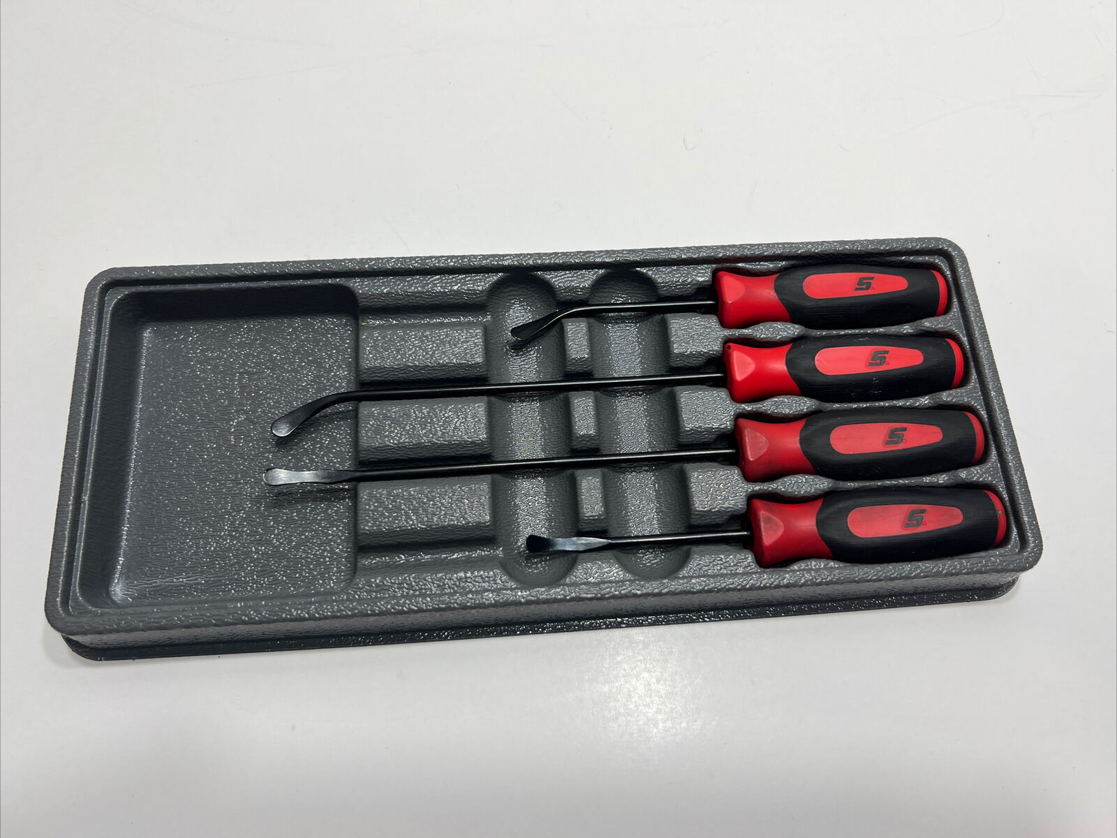

Snap-On makes a set of tools to help with seal lip and O ring removal. I used mine to fix a seal lip that had rolled on me. You can purchase the same set with different handles on Amazon under the Sunnex brand. I have also used Saran Wrap to protect the seal lips when installing them, and then carefully pulled it off the shaft.

Thanks for the sunex tool set suggestion, I ordered it today and should be here tomorrow. I appreciate your advice and have ordered a new seal, this tool is exactly what I needed and didn’t even know such a toon existed. I am hoping to be successful this try!
