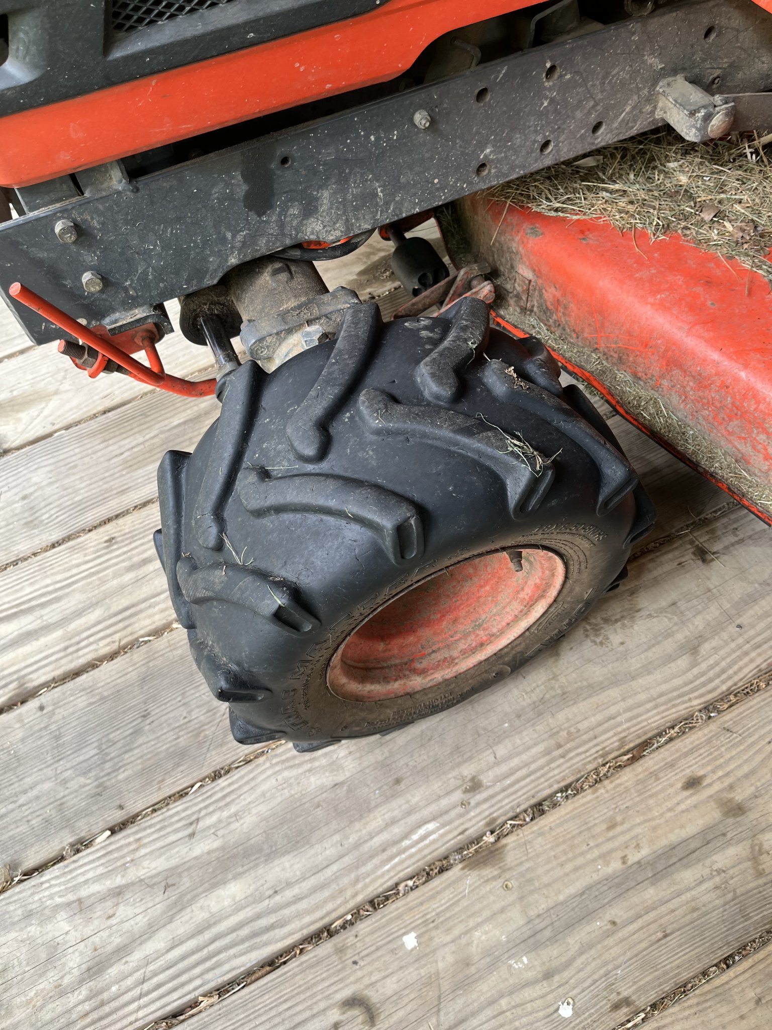

My BX 2200 is close to 20 years old. This is a picture of the original front tires after 1485 hours of service. They are foam filled so air pressure doesn’t play into the wear pattern. But actually I’m pretty satisfied with the service they have given me to date. So I guess what I’m saying is perhaps you have an issue with alignment.
edit: I don’t have a loader, though. My B 2910 does. Don’t need two…
