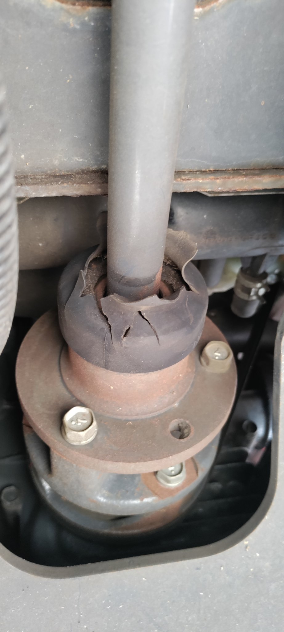

Check your tie rod boots for rips or tears. If needed replace with aftermarket
Pay attention to the fluid level in your front axle.
