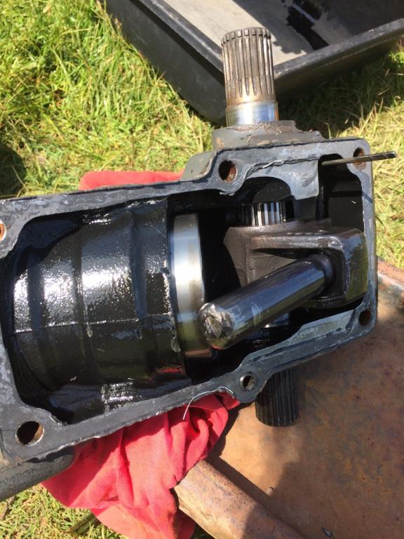

This is the second time this happened. The rod comes clear out of the piston and jams against the clutch. The first time the three point was forced up when a tiller caught a bank going downhill. After a complete trans overhaul (because I went at it backwards) it has done it again without any attachment on it. How do I fix this?

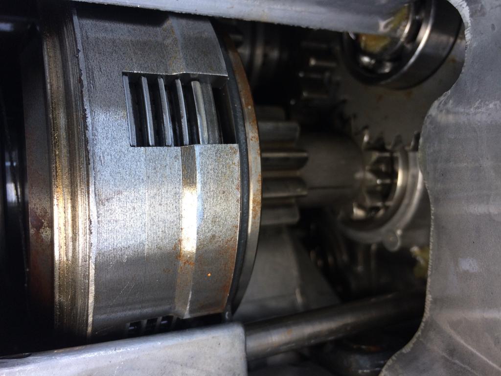

The first time it happened it broke out a cross panel part of the trans case you can see in pic #2. That time there was a lot of force involved. I wonder if that piece across the case is want keeps the rod from dropping past the socket of the piston. I can see a small wear mark on the rod where it would touch that broken out piece. The clocking of the arms could be the problem for the second time. Only reference I saw in the WSM is "align the marks". There are no marks.

I would dry set it and try and get it to fall out.
I think your going to be disappointed.
I'm sorry I didn't notice that the web is broken out of the transmission (what we call the rear end), that is the part that keeps the rod from falling to far to fall out of the piston.
This all goes back to the original repair, the case should have been replaced back then.
If you had the broken web you could have had it welded back in place. :(
