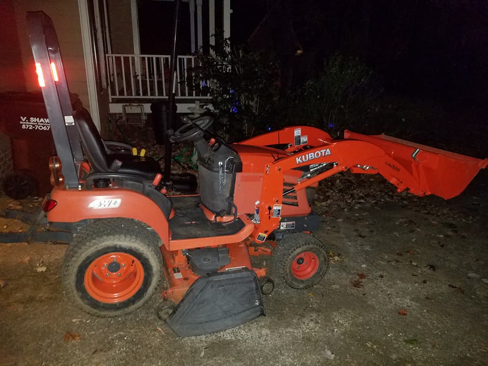

The BX1850 followed me home. Ran great, looked to be well-maintained. I couldn't find a leak anywhere. The front axles look good, no leaks, and the boots are good. The only very minor things I could find wrong were the cruise control lever is broken off (I'm sure that's not a difficult fix, but not any high priority since I'd rarely use it), and a weld on the positioning rods of the 3PH lift was broken (also not any big deal...this is the adjustable contraptions that control how far apart the lift arms are spread when nothing is mounted in the 3PH). The loader on it is practically new, and the bucket still has the paint on it, so it has seen very little loader work...the seller said it was mostly used for mowing, and the mower deck shows some use but seems to be in good shape. The forward/reverse treadle sticks just a little, but I recall there's a return-to-neutral spring that might need adjusting and/or maybe it just needs a hit of grease.
I was concerned that the BX1850 might be too small, but it's not as small as it looks in most pics (I guess the "lawn tractor" styling is a little misleading perception-wise)...I think it's probably just about right. With the CarryAll that came with it, it just barely fit on my 5x10 trailer.
Regardless, I'm pretty pleased at the moment.
Cheers,
Dave

I've only gotten maybe 20-30 mins of seat time so far...but I see the forward/reverse treadle is sticking in non-neutral sometimes, which I gather is a pretty common problem. Looks like there's a grease fitting under a flap on the floorboard, and there's some fixture with adjustable spring tension under the right front fender somewhere...I'll hit it with the grease gun and give that spring tension a look at my next best opportunity. Doesn't sound like a difficult fix/adjustment.
Question: How does the parking brake lock work on the BX1850? Do you push it down to lock the brake, or pull it up to lock the brake? Not sure whether this is working properly or not...it's not completely clear from the manual which way you push it to lock the brake. :rolleyes:
Dave
10,948
2,779
Dave
yes - that zerk is OFTEN overlooked!!!!
Is there a "button" on the floor? like a round little quarter size button?
If like the '70 series - push break and hold button down, and let up on both.
Curious - I notice the paint looks bright on the FEL and dull on the rest, is this correct or just the camera playing tricks???
Where is the damage that the person was talking about ...plastics???? or am I thinking about another machine?
looks like a great machine!
