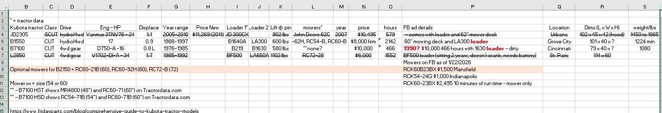

I am hoping for a 4 cylinder, would be delighted with a 5. I'll have a look at those models.
I did something similar with options that come up on Marketplace, made an Excel file with selected data for each model, that's how I knew the B7100 was smaller than I wanted. I'm making the assumption that tractordata.com is pretty accurate, it's been pretty solid for the JD's.
I'm also keeping track of decks and loaders that come up for sale in case I find something that is missing one or the other, haven't updated it with that info yet.
I will DM you for your list, thanks.
