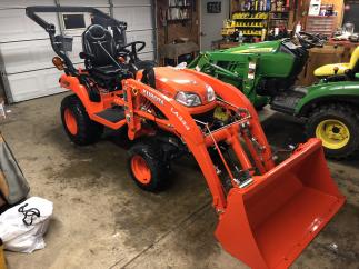

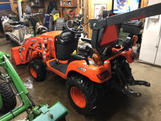

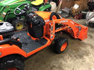

Here is finally some pictures I promised of my 2013 Kubota 2370 with a brand new LA340 loader, Kubota loader leveler bar, and a bx 2380 floor mat. In most of those pictures you can see it sitting next to my fathers 2016 John Deere 1023E :)
