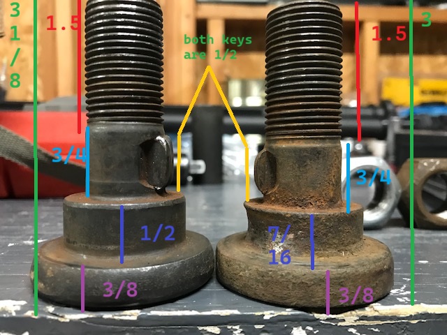

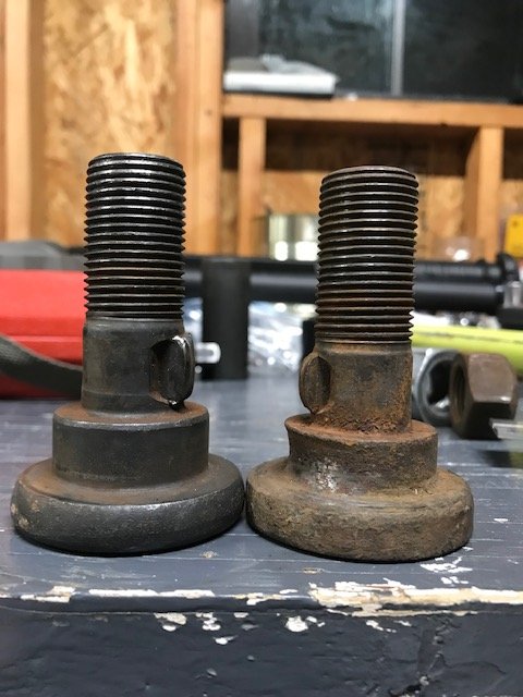

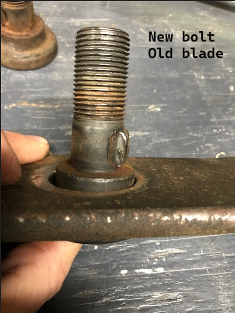

A little hard to tell from pics, but the key on the new bolt looks a bit thicker than the key on the old bolt. You sure the new bolt key is seating correctly in the carrier slot?

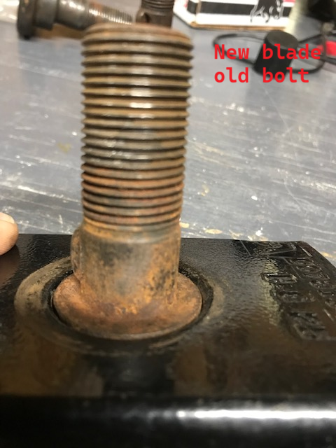

Ok got it:
The nut is bottoming out on the shank before its tight!
(Purple lines)
Put a hardened thick flat washer under the nut.
hopefully you are on to something. I measured the keys up and down..let me check on width when I get home. thanks

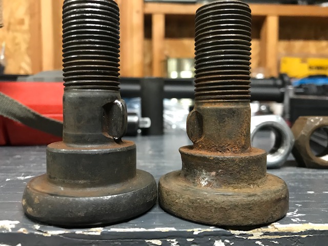

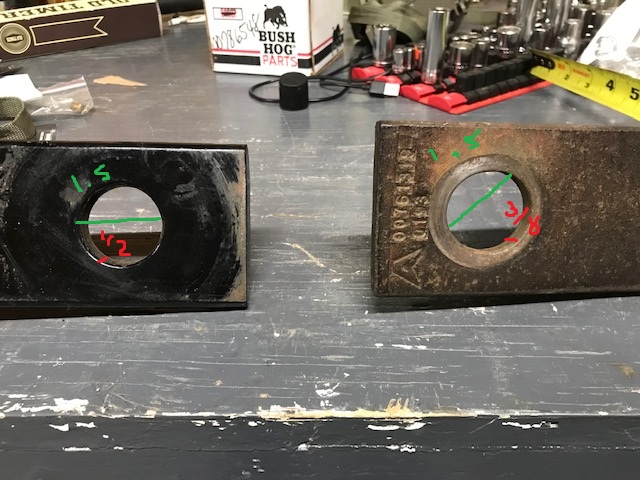

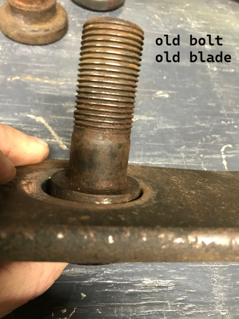

The bolts are both 3/8 at the bottom, but were the blade sits, one is 7/16 and the new one is 1/2'". I think the new bolt is wrong for the blade.
36,081
11,042
The new blades are 1/2" ,old blades were 3/8.
So the new bolts match the new blades.

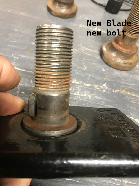

I remembered to look at this today and the tip of the blade is free to move 3/4 of an inch from full down to full up, when fully extended out like it is during operation.
The blade is about 3/8 inch thick and 18 inches long.
The bolt has about a 7/16 inch long shoulder for the blade to sit on (shown below).
The blades and bolts are OEM from Modern Ag
