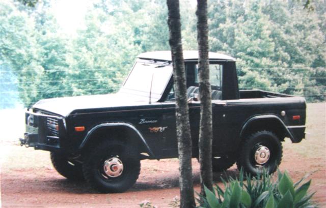

All early model Bronco's had a Ford 9" rear end (not an 8") and the '68 would have had a Dana 30 up front.
But yes, the gear ratio's were a product of what was available and not a design feature.
The ratio difference is insignificant and would only be in play when the vehicle was in 4WD (Tcase) and the hubs were locked anyway.
And without power steering.....I can assure you nothing will improve the steering of an Early Model Bronco. I've owned several....and still have one to this day.

Nice uncut Bronco!
And yes, I meant 9". A great axle btw.

Nice uncut Bronco!
Flintknapper's Bronco is good looking! I like the tire and wheel treatment and front winch bumper and winch.
It does look like a "cut" Bronco to me though. That term refers to opening up the quarter panel wheel well openings correct?
Yes Sir. Most cut Bronco's I've seen have Serious sheet metal cut out. Especially the rear quarter panels, to clear much larger tires. Flintknapper's Bronco appears to have factory wheels and that threw me off. I'm a Jeep guy for decades, and that one slipped by me 'cuz I'm no early Bronco expert. And, because it looks so original. Nicely done @Flintknapper .
It IS a 'cut' Bronco and has factory wheels but they are the 16" optional wheels not the 15" standard.
It has some other alterations as well (4 wheel disc brakes, NP435 four speed, lockers front and rear, 23 gal fuel tank, etc). I've owned this one for 40 years now.
