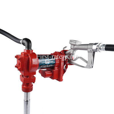

Fill-rite pump, suction tube, hose, nozzle (replace with auto stop), filter housing, battery from lawnmower and done.
Cheaper generic copy.
