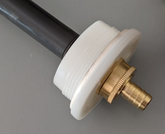

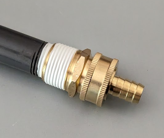

It took be a bit to figure out how to make a 55gal drum pickup I was happy with - the key was the dual adapter. Three sets of threads on one piece - female threads for the dipper, male threads for the bung and hose.
Pickup assembly.
Pipe nipple trimmed to length and notched for water pickup.

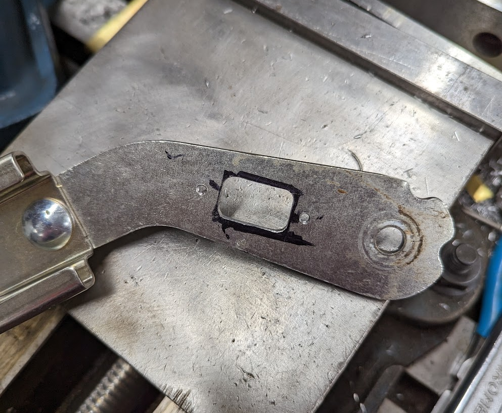

I cut an opening in the SMV sign bracket for the power socket. It sits right where the spare loom is and is a part I don't mind mangling a bit.

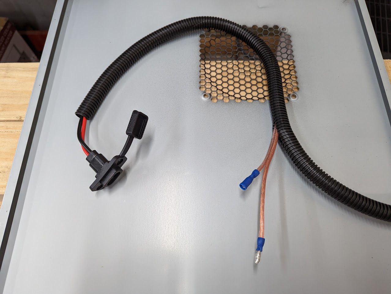

SAE sidewall connector with some wire extension, split loom, and crimped bullets.

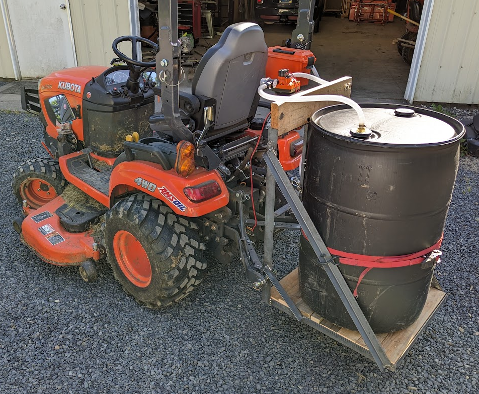

All mounted up. It's plumbed into the always-on loom tucked behind the fender that Kubota uses for work lights. Nice of them to have it there with a 20A fuse ready for anyone to use. With wrapped split loom and ties and it almost looks factory.

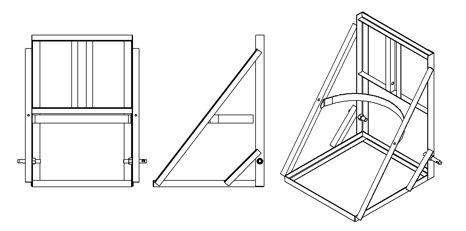

Steel cut list.
Weld drawing.

Some of the worst welding you will have seen. You might wonder if I welded the diagonal supports upside-down, and you would be correct. I am far too lazy to change it now, it'll do.

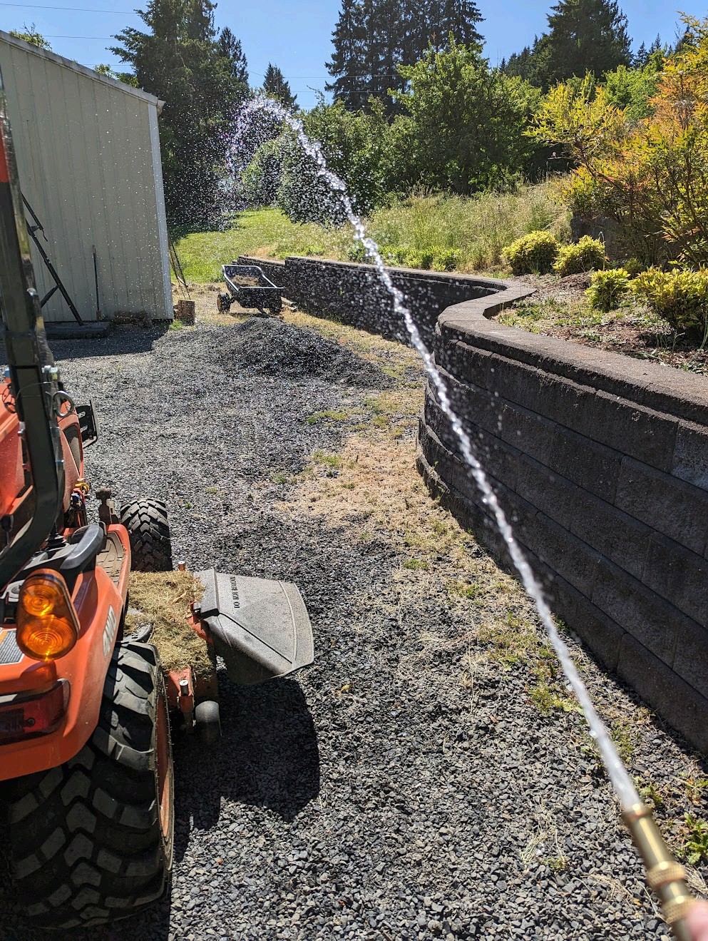

All mounted up and working! Holds about 400lb of water just fine.
These little pumps have great power!
