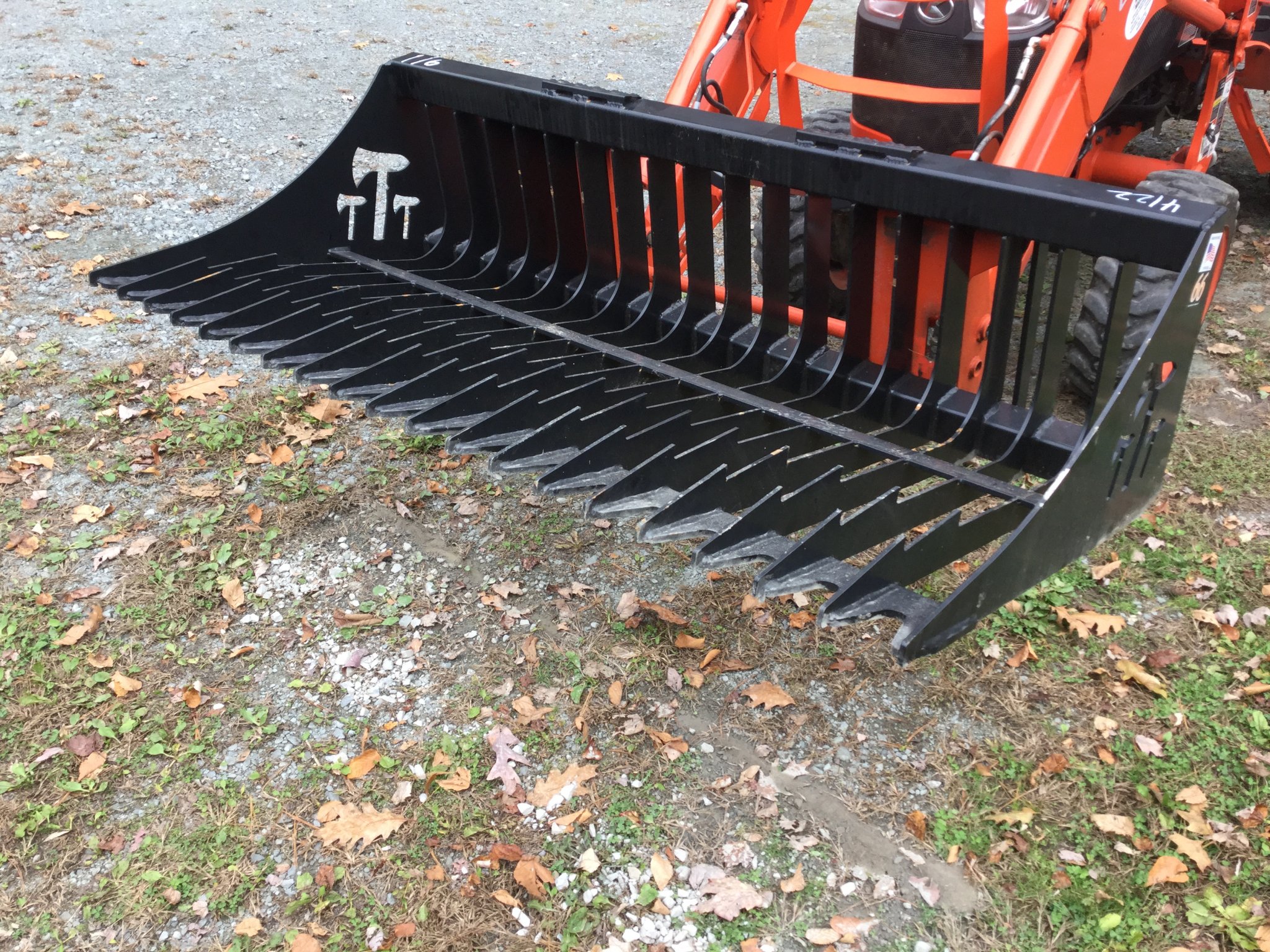

I use the standard bucket with a blade on the front of it, She gets used hard and is standing up much better then the steel welded on blade from the factory.
