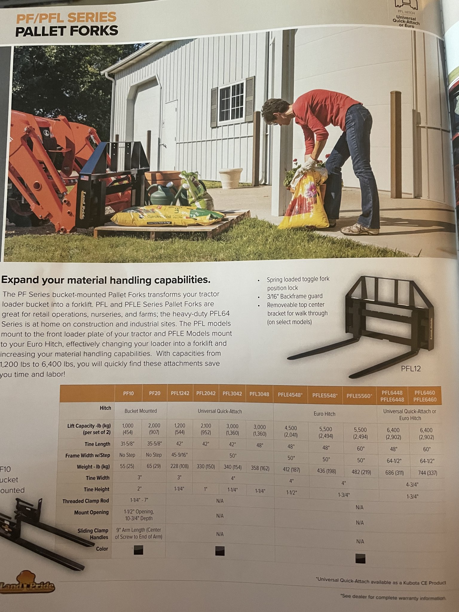

My other (it’s much larger for the Mx)is a landpride and it’s very nice too. I have no idea on current prices though.below are what the specs were from a year or so ago on land pride offerings in the forks.

I did see the land pride 1200lb forks and my dealer had them in stock when I picked up my unit. If they're any good, and adjustable, I might have to go that route to avoid waiting. Honestly speaking, the LX2610 can only lift 1k anyway, anything rated higher than 1-2k seems overkill.

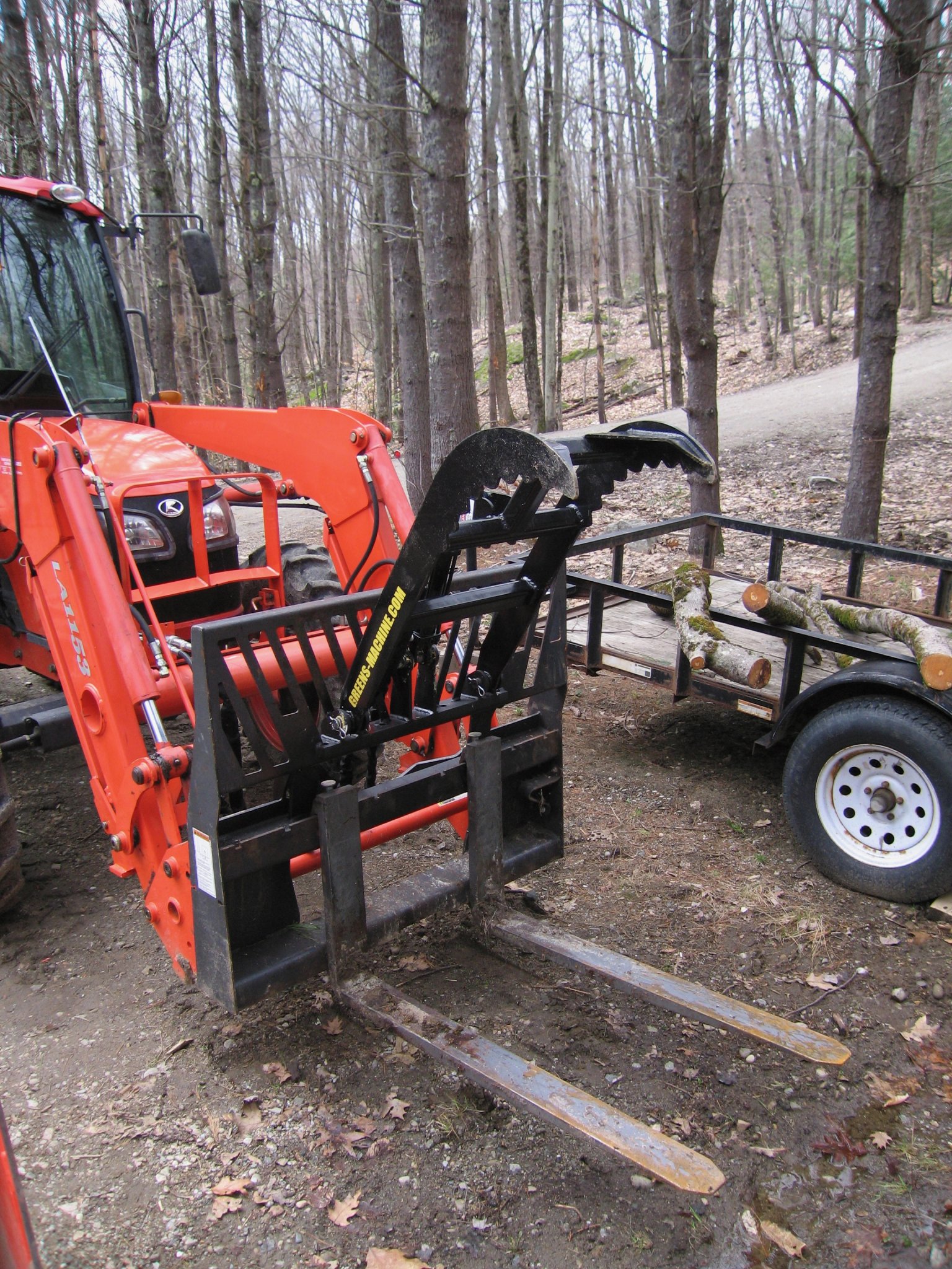

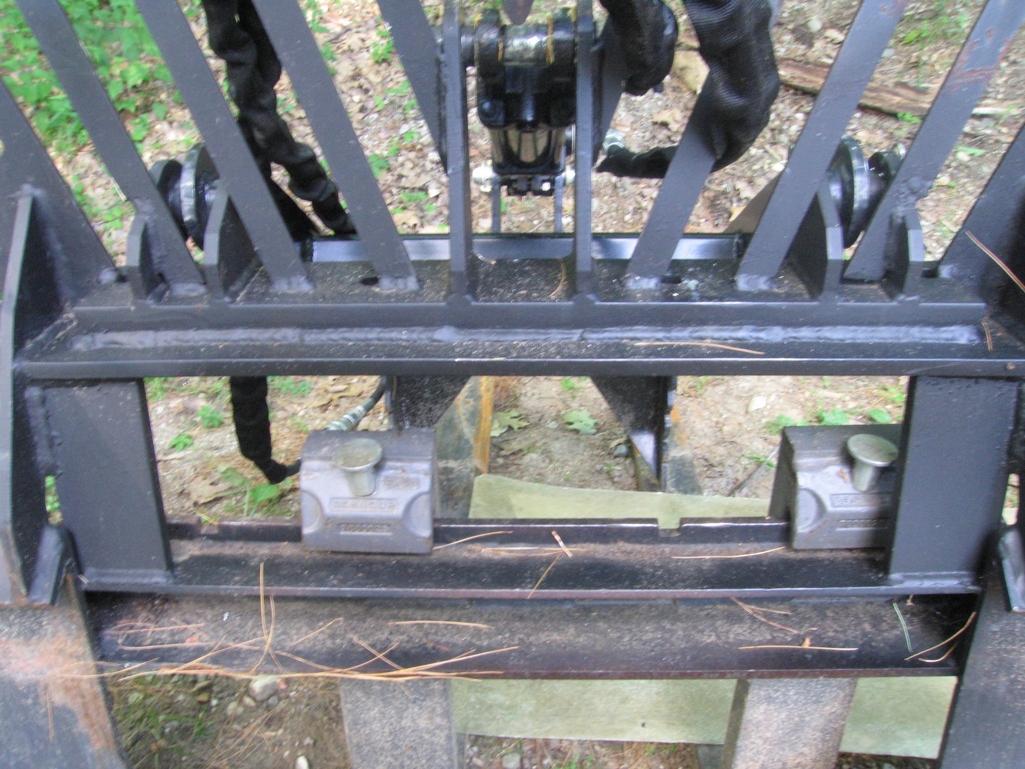

I put a Green's Thumb on my pallet forks and also added a third fork [not shown in pic] to help hold shorter stuff.
For the price it is a really handy tool

That's a slick set up! How did you attach it to your forks and what length thumb did you go with?

Your machine is quite a bit bigger than mine, what forks are you using? It also appears that you had to cut the headache rack to weld the thumb mount and then weld the headache rack supports over the thumb mount - am I seeing that correctly?

4000# Virnig forks. Yes, some cuts were needed; and the thumb mount is welded into the headache rack.
Very clean install by a welder friend.
