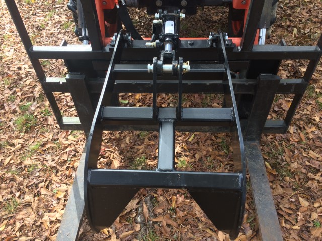

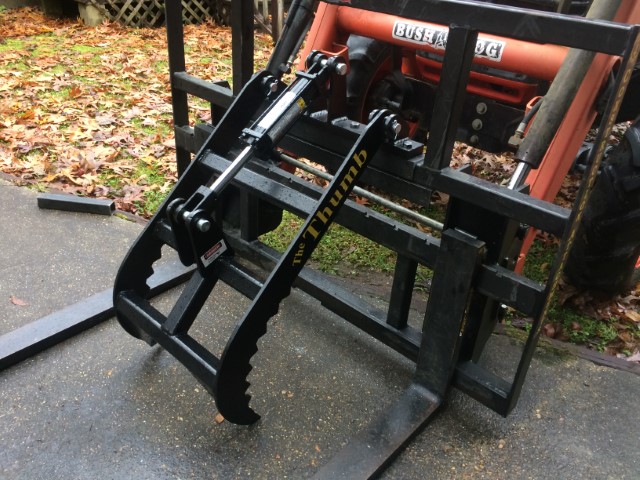

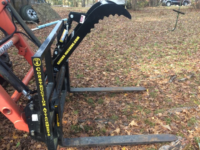

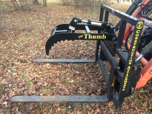

My 36" Thumb is bolted to the forks. I am well pleased with the way it grabs and holds logs/debris to the forks. Once I clamp down, nothing falls out.
I used the smaller hydraulic hose (3/8") which reduced the cost and does not require the flow restrictors. It still has good operating speed.

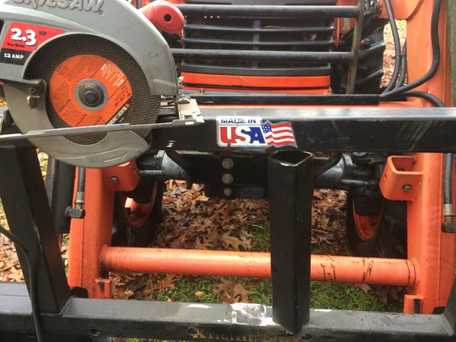

Did you cut out two bars in order to bolt to your forks? Also do you know the weight of just the 36" thumb? Thanks.

I only had to cut out the one vertical bar in the center as shown here. IMG_8765.JPG
That left plenty of room for me to bolt the thumb bracket.

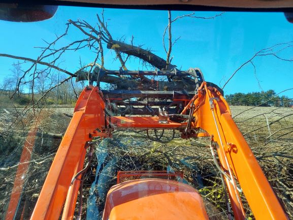

We have forks, grapple, and a buckets with hooks. We started cleaning with the buckets and hooks. Worked well, was just time consuming.
The forks work well, but still require you to pile stuff up and do a lot of manual labor.
The grapple speeds the whole process up dramatically. Dad and I both wish we had gotten the grapple when we first started, but are thankful for having it now.

I agree, of there's any real amount of brush or logs a grapple can't be beat. Having said that I'm biased as I heat with wood and handle brush quite often. If I have to move more then a truck load I end up renting a grapple. It's cheap to rent and I don't have to keep it around.
