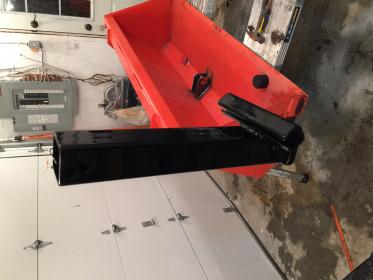

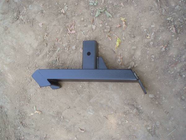

Built a new receiver for my bucket today that may interest somebody. Very easy to build and works very well. 18" Reese receiver blank came from Summit racing, and I used a couple of pieces of 3/16" plate and a piece of tubing I had laying around. Receiver goes on with one pin and no tools. Used it to move a 30' boat on the trailer with ease. I obviously bought the wrong colour paint which I suppose this coat becomes primer, lol.
