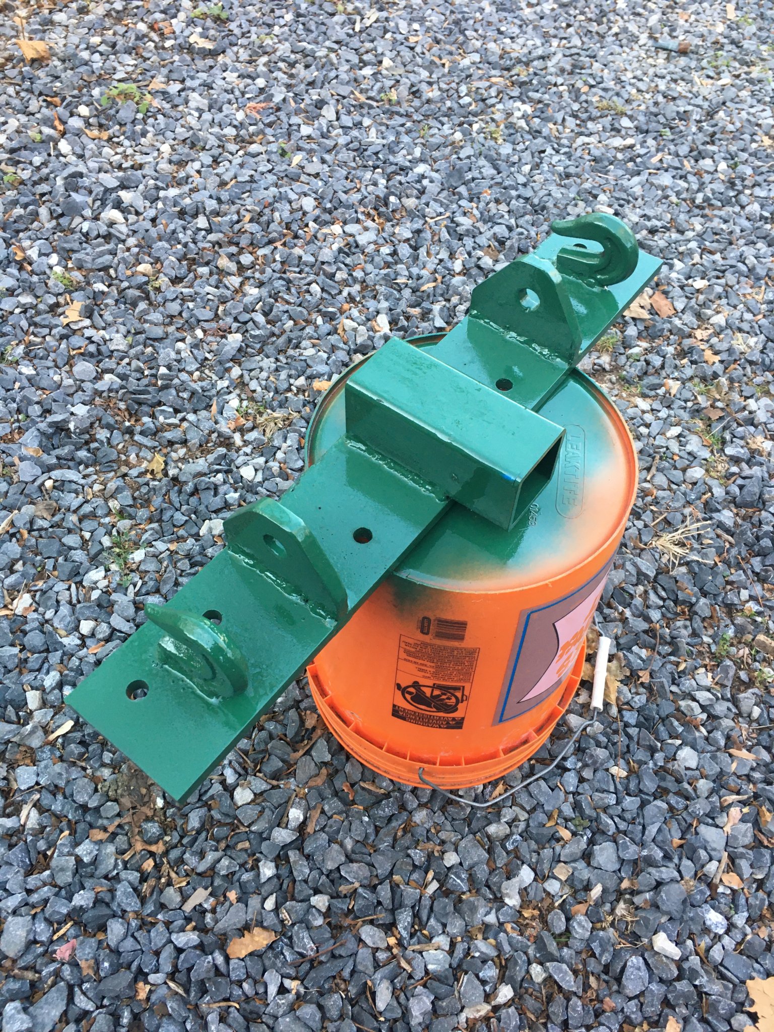

Ken at boltonhooks.com can supply everything you need plus instructions for installation so there won't be any guesswork. My BIL uses them and they're very nice.

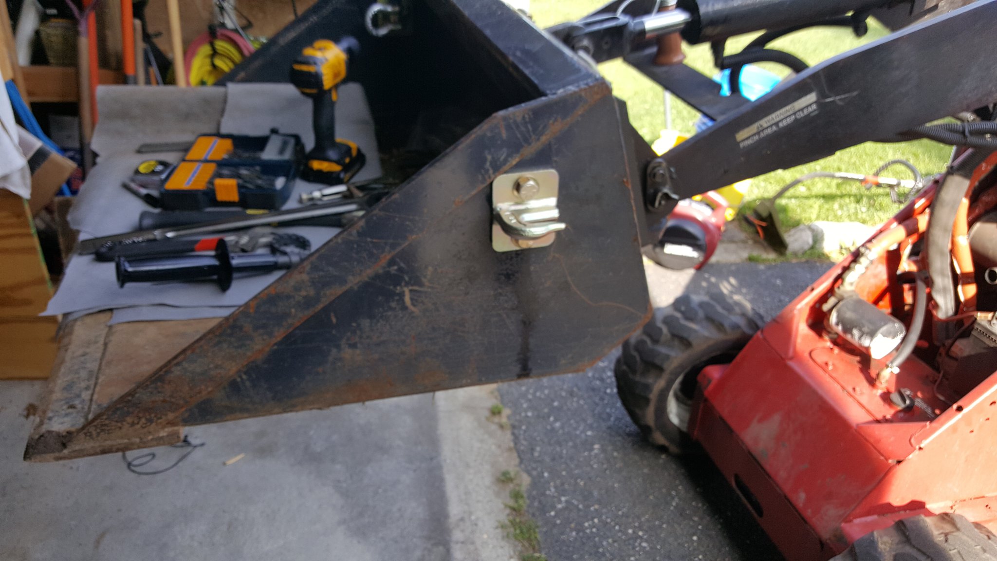

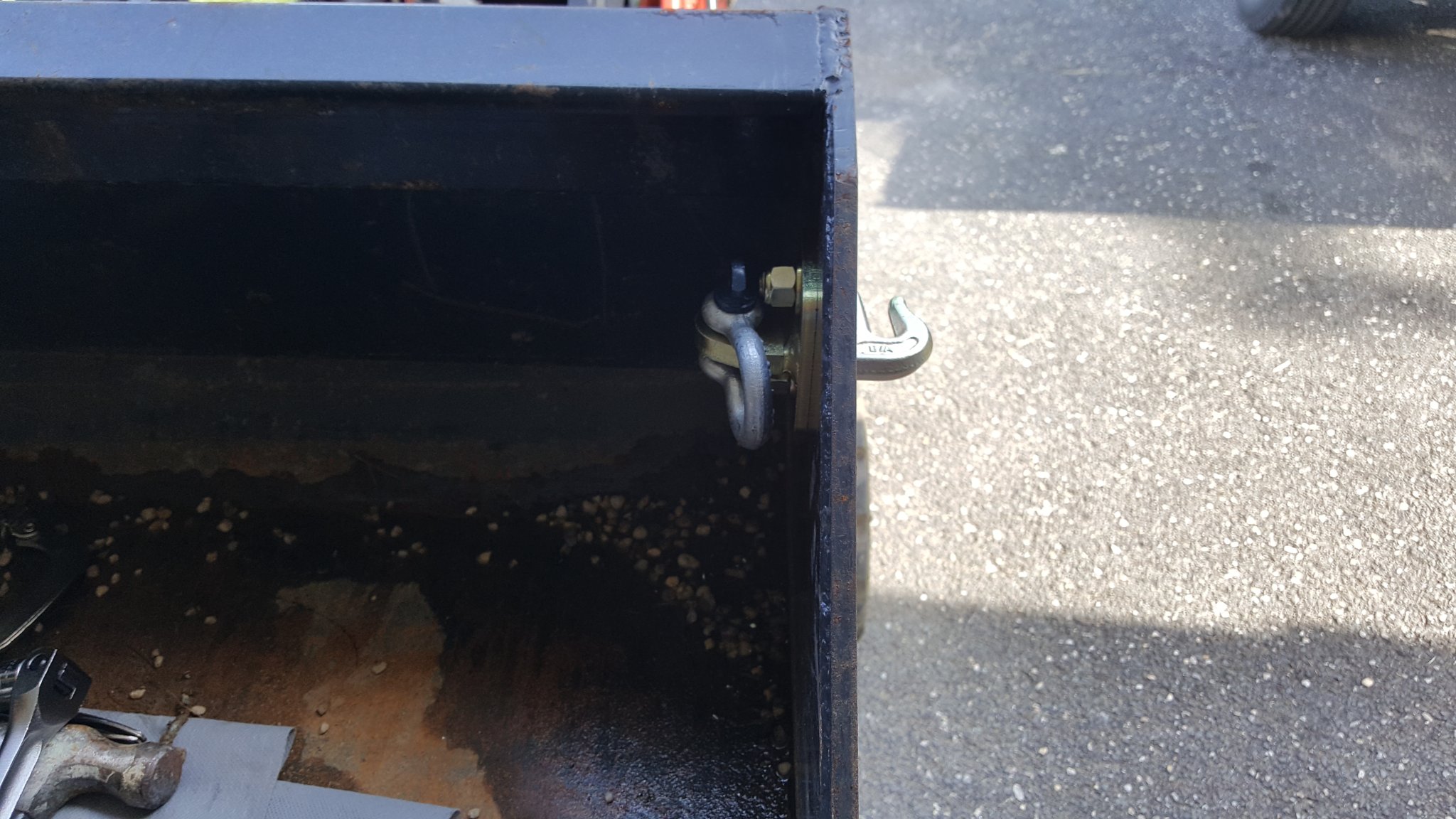

Just got a L3301 with a 60" bucket. Bought a couple of bolt-on chain hooks from eBay. Don't plan on any super heavy lifting, but missed having something like that on my last tractor. No particular use intended. Is there a preferred location for mounting? The mounting in the photo seems poor with a gap between hook and backing plate.
I initially put a pair in mine, in line with the cylinders. Works well for strapping something to the bucket to carry it around, but lifting something heavy, it causes the tractor to lean a bit, so bought another set. Mounted on the center, gave the other to my son for his tractor, as he was experiencing the same thing. Recommendation: Install 3.
