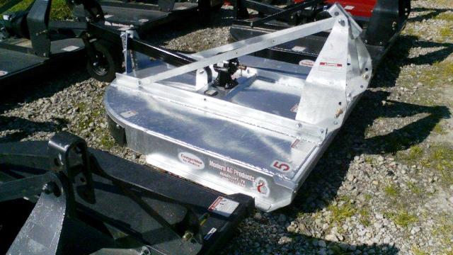

One thing to look for when buying a brush hog to cut heavy brush is the thickness of the steel in the deck and side skirting. The light weight decks will get banged up pretty good when running over small saplings and brush, especially anything getting close to 2 inch diameter. I bought a 5 foot Competitor made by Modern Ag Products in Beaumont TX. It has a 3/16” thick steel deck and ¼” skirts, and a heavy duty gear box. I got mine on a scratch and dent sale for $1000, but I believe they normally run around $1500.
I’ve run over some nasty stuff and haven’t put a dent in it yet. Basically I’ve found that anything I can drive over I can shred up. I’m mowing mostly Yaupon, Cedar and Mesquite. You want to take it slow and use extreme caution. Be sure no one is standing anywhere near where you are mowing.
