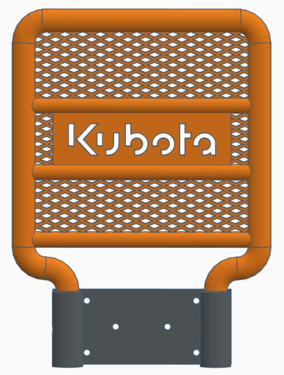

I've been working on ideas for a custom brush guard for my BX2230, I so I used Tinkercad to design a scaled down one to see how it would look. So, this is what I came up with. I will talk to a local fabrication shop to see what it would cost to make it out of 1 1/2" steel tubing. I can have another local laser shop make the Kubota logo panel, then weld it in.
I'll make a mount that the bottom tubing will slide into and be secured with clevis pins. That will make it easy to remove when I remove the cowling to change oil.

That is a beautiful piece of work. Would like to have one for my MX. Only addition/correction would be an opening above the plate on the bottom as that is where I thread my chain thu when I put it on the trailer, which is often.
My MX is about a year and a half old, 140 hrs and already I have two holes in the grill from sticks poking their way into it.
Again, nice piece of work.

That's really nice, however since you're in the fabrication mode why not add some expanded metal to keep smaller branches off the tractor?

How is this?
I changed the perimeter tubing to a more realistic 1.5", and the cross tubes to 1".

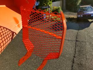

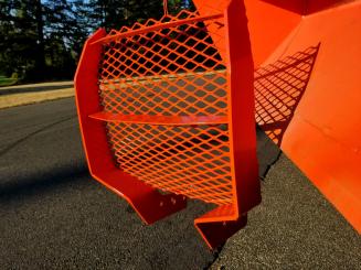

Had a stick puncture my black mesh in the hood assembly on my '18 B2650, so I whipped this out one afternoon.
Wife painted up the initials of our start-up business for me to attach to the guard :)
