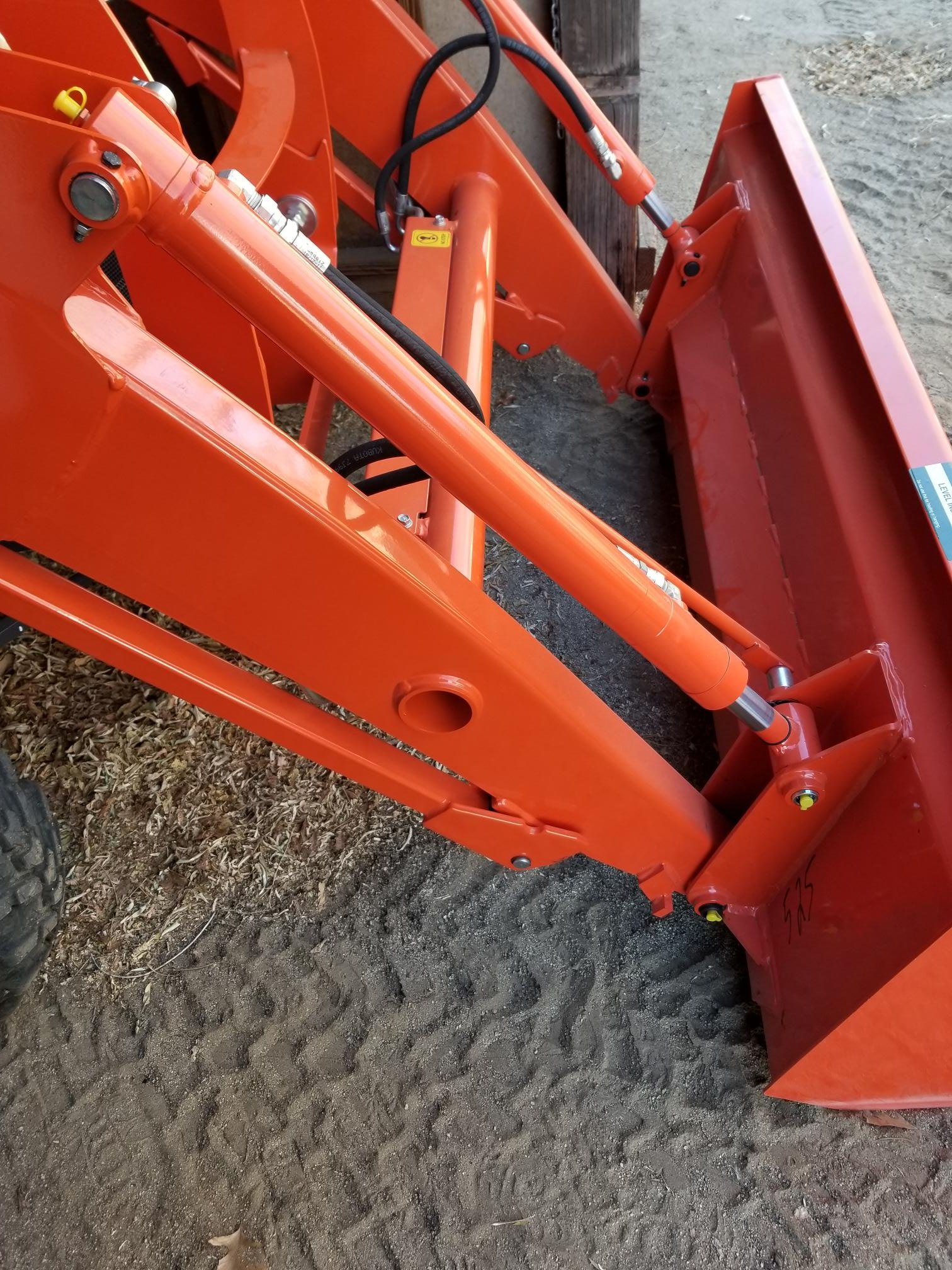

Bummer...as I also have a new L2501...only 3 hours on mine...I did double check Engine Oil, Coolant and Hydraulic Oil levels...double checked all zerks (found bottom of FEL cylinder fittings dry). I need to still check front Axle fluid level...as that issue has been posted on OTT before. Going to do that right now!
I did request the PDI Sheet (attached for reference).
Suggest you ask the Dealer for yours...
Good luck!
Good luck!
Removed Front Axle Check Plug (right side of axle)...Fluid Level good!
FWIW...I also put yellow Lock N Lube fitting caps on all my zerks...mainly so I know where the heck they are...does keep some dirt out I guess...but being able to find them was the main issue.
