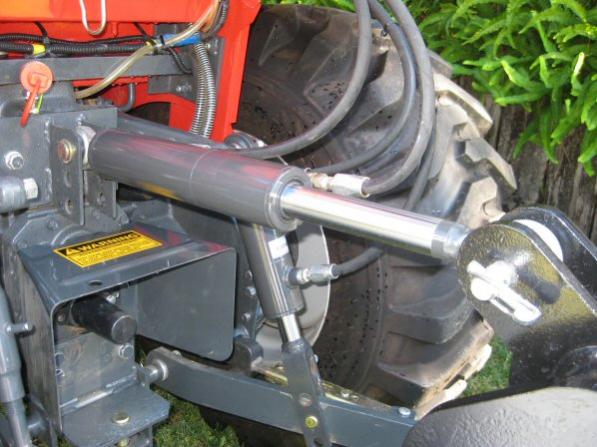

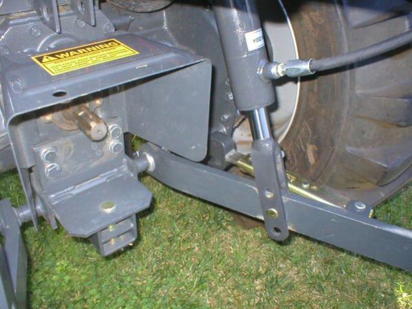

If you want to make it easy to do adjustments like that look into a top and tilt kit, it will hydraulically tilt and pitch the blade right from your seat on the tractor.

Like was mentioned, top and tilt for your 3pt hitch. If you are going to do much grading of any kind, it is the way to go. :cool:
Do those cylinders tend to stay where you put them, or do they bleed back at a bothersome rate? The stabilizers on my old K650 backhoe would never hold against digging for more than a few minutes.
As far as your "OLD" back hoe, things were probably just warn out. Seals bad, rings warn, spool valve warn, a combination of it all.
My experience has shown me that the control valve is usually at fault for leak down. So do these cylinders drift down, yes if you have a bad control valve, otherwise, normally no. ;)
I certainly tend to agree with you - there is no sign of leakage at the cylinder. The old backhoe had the problem from the get-go, however. I only use it occasionally, so there has never been justification to buy different valves. I have contemplated the "tilt" portion of a top-n-tilt a lot lately. Thanks for your reassurance!
