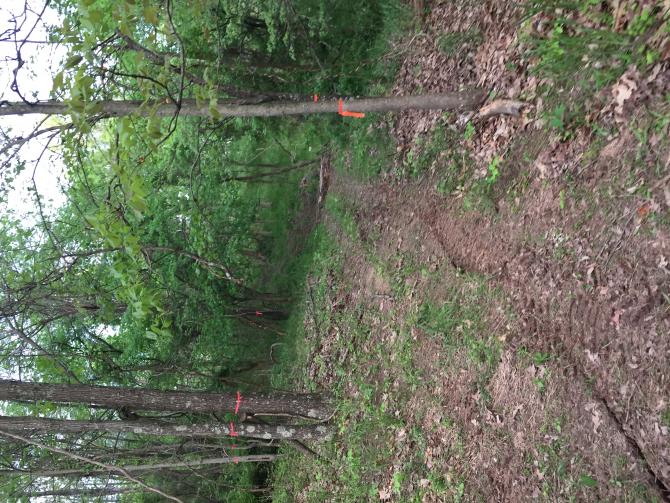

In my never ending homestead path work, im running into a lot of issues box blading. I know I have a small machine and limited power, but I seem to get hung up on roots very easily, making the tractor full stop. Even little finger sized ones hang me up.
I’m a novice, so any advice is welcome.
Some things I try,
Setting the angle to the box so the ripper thanks only penetrate an inch or so.
Raise the height to where im only skimming a little.
Only using two rippers.
Tractor is in 4wd, low range, reved to redline, and I don’t stomp the HST.
Is there a ripper shank that’s a blade available for my LP BB?

Small update.
I had a fella come in with a dozer and give the whole place a work-over for a couple of days. Damn... even a little JD350 is like the hulk. He pulled up shitloads of stumps.
With the big stuff broken up, I used the root rake on my grapple to scoop up a lot of the roots. Made a big pile of them.
Hopefully the box blade will do a better job now that the soil is broken up.
