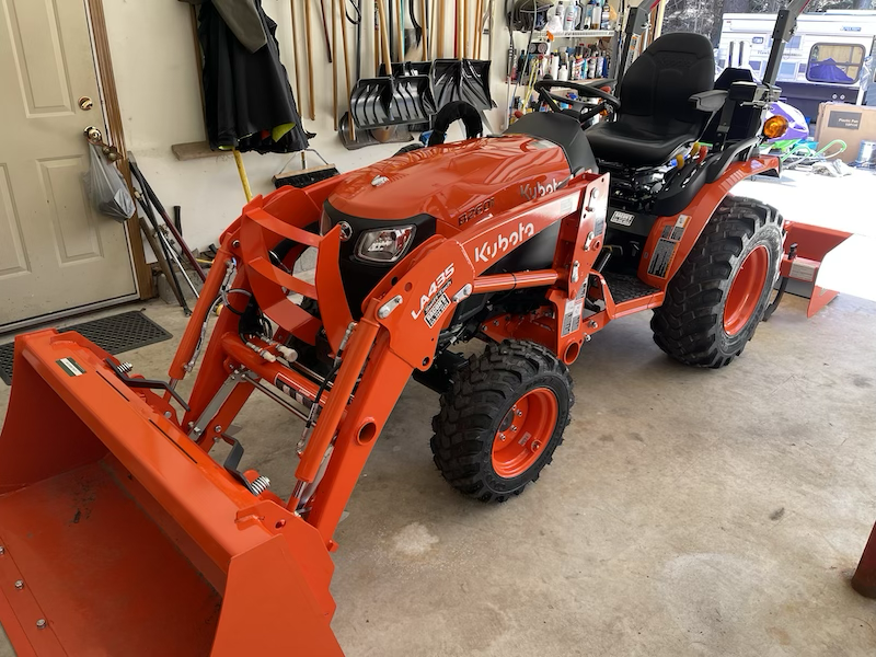

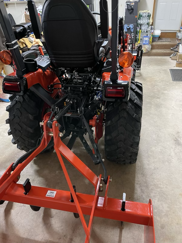

I have a BB1254 for my B2601, I'll attach some pics to help you visualize it's size relationship to the tractor. tempImage8d5Mj8.png tempImageLzchfw.png tempImagechsKMJ.png tempImageJjIass.png tempImage86yEjz.png
