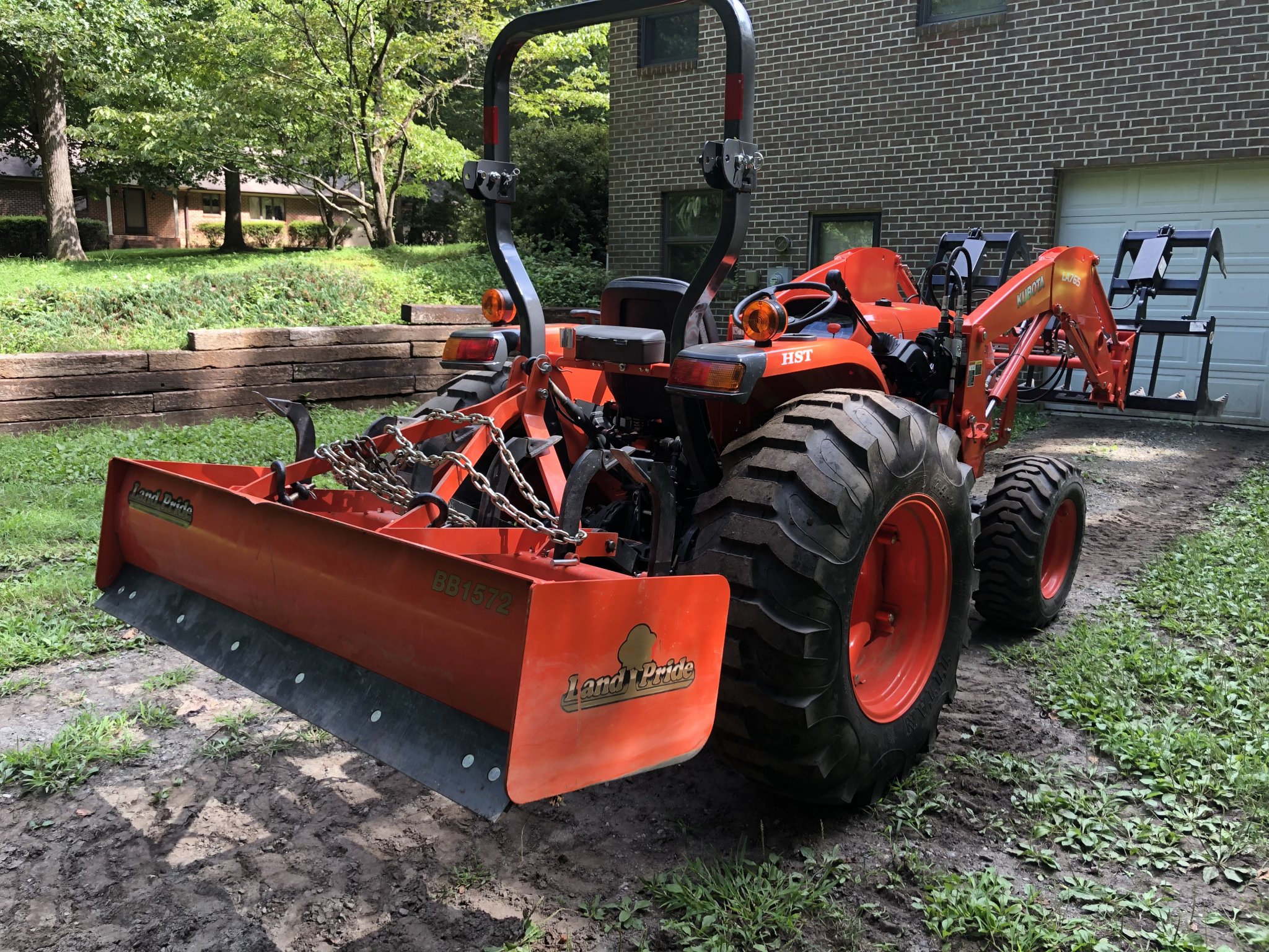

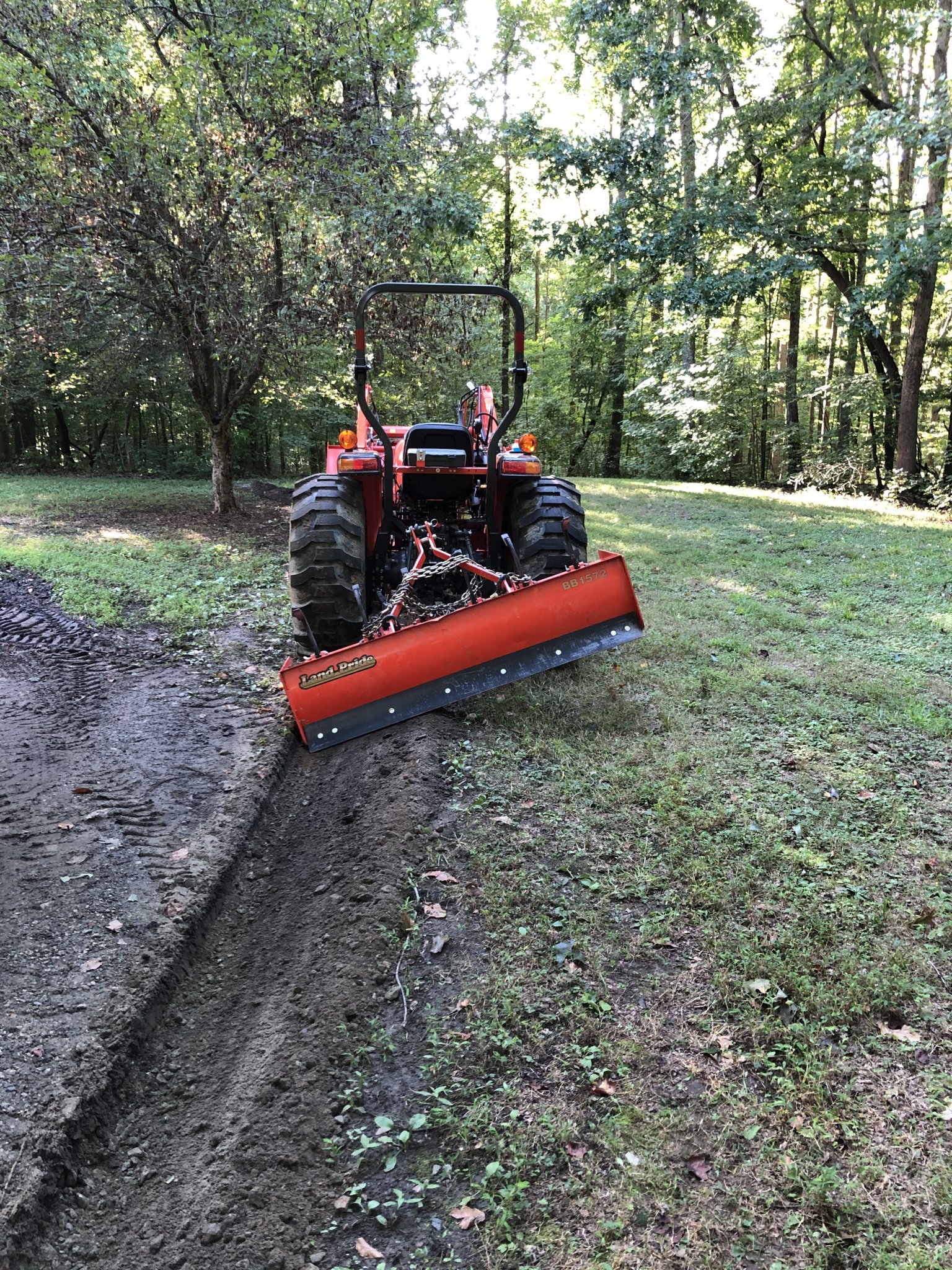

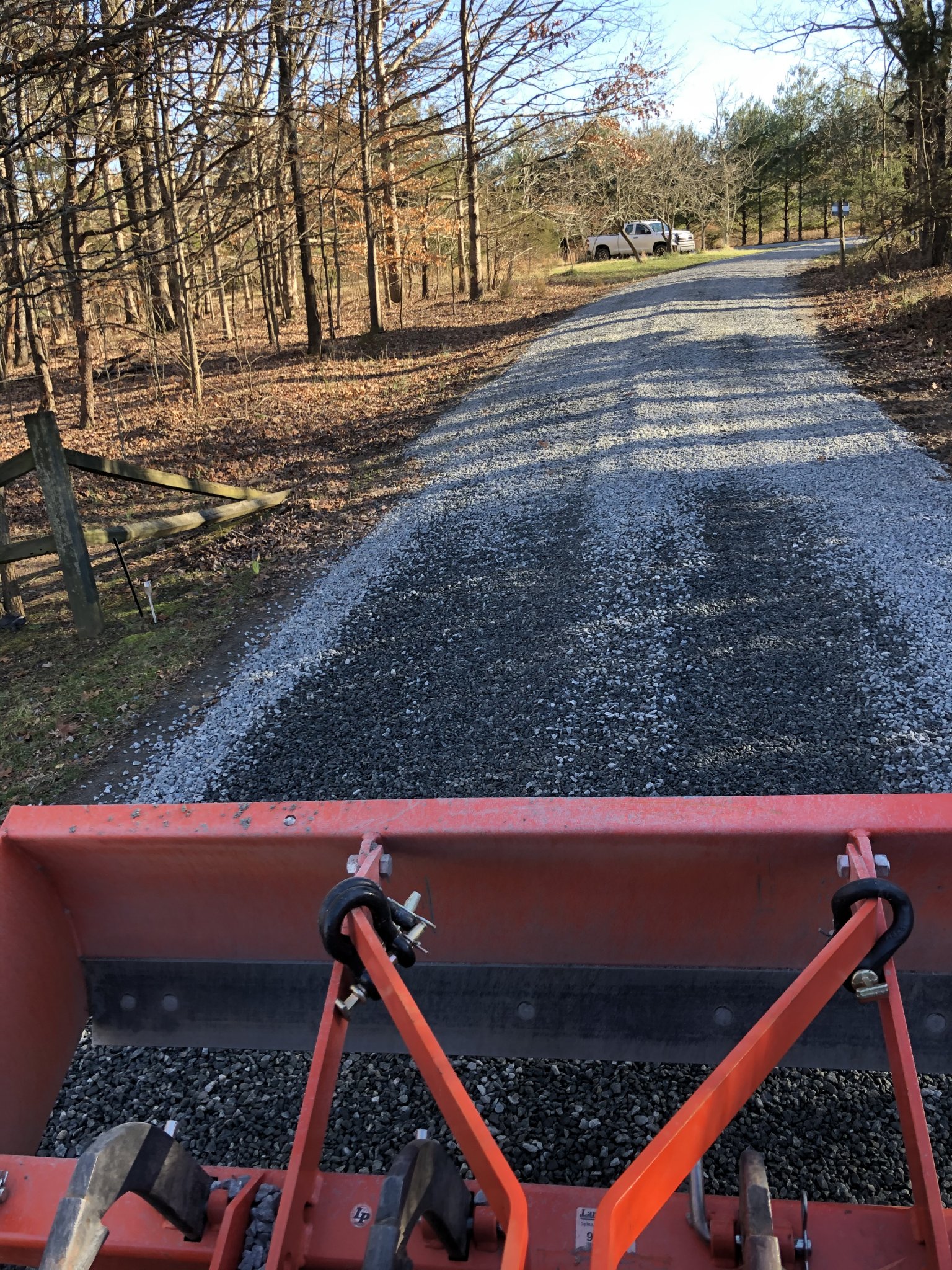

I have a Landpride BB1572. 504lb 72”. Manual rippers. Fixed rear gate. Nothing fancy. Heavy enough to cut into the ground without rippers most of the time. For heavily compacted gravel roadbed or packed drought dry clay, drop the rippers and it will get the job done.

I see your 15 series has pins, not the silly little spring clips. I like that. I don't see that much heavier construction in it over the 12, but the better keeper design on the rippers is what I like.
Judging from the nifty little ding on the backgate, looks like someone else pulled a chain tight across the back of their blade. DOH!. I knew better when I did it. A 2 pounder with a 12 pounder for a backup works nicely for box blade body work.
Is that top-n-tilt or manual tilt? Dat's a LOTTA tilt! Even with the 72" blade, behind your L4701, it's still almost too narrow to do what you're doing there. The next pass will have that left rear up on the shoulder, or certainly up against it, or am I looking at a bit of parallax? There's a couple places in my yard that I need to do this to. The difference is, you have real top soil and grass. I've got the remnants of the old city dump, I think, mixed with hard clay. No way am I cutting that deep. I could weight it, but then my LX would just spin all four and bury itself very quickly. Haven't stalled it pulling, but have a couple times pushing.

1. Chain ding on the top. We have a winner! At the time I did that, I had a pretty good idea it would dent or at least put some scars on the top of the blade as I needed to pull both up and forward really hard, but didn’t much care right then and still don’t. I’ve left it like it is because honestly I’d probably do it again at some point and it’s not denting any further with additional hard chain pulls. Seems to have reached a point of equilibrium with the chain pulls.
2. The extreme angle was before I got the top and tilt. The rock shaft links have three holes at the yoke that attaches to the lift arm to allow for a lift height travel range adjustment.
Hooking one side in the top hole and the other side in the bottom hole adds to the tilt. Makes hooking up a wee bit more difficult. Now that I have the hydraulic sidelink and have replaced the fixed sidelink with the turnbuckle sidelink, I can achieve the same results without involving the unbalanced lift arm arrangement. The back tire pretty much tracks in the groove, but you’re right that the blade needs to move a bit left to really be in the right place. The hitch is centered there. It can offset a little more to the left with just the standard sway bars. The turnout I’m cleaning out there is ABC crush run granite that silted in with dirt, grass, etc. so it’s basically scraping the junk out of a gutter there.
The turnout was originally cut with a moldboard plow, backfilled with the ABC stone to stabilize it, and then dressed to final shape with a backblade. That was with the 9N long before we met the Kubota.
Edit: BTW, we didn’t have topsoil here either in the beginning. Nothing but red clay. Numerous years of enough lime and fertilizer to keep the grass growing and then mulching the grass and fall leaves eventually built up a soil base for the grass. Only took about 10 years.
