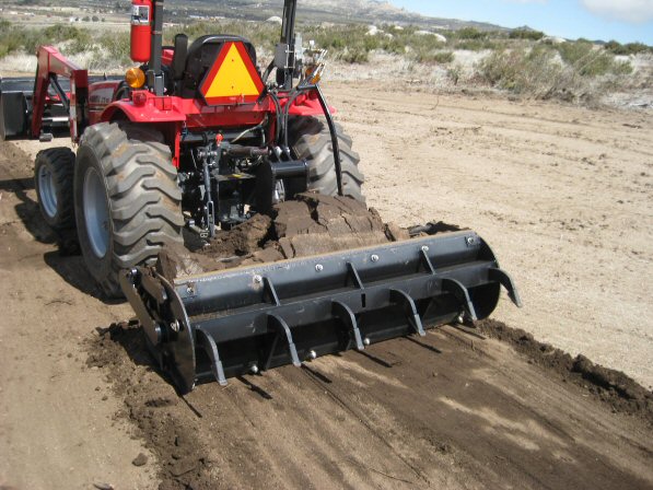

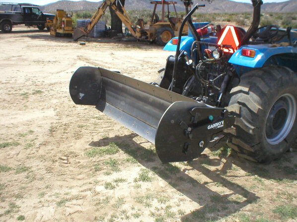

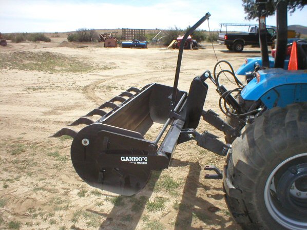

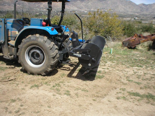

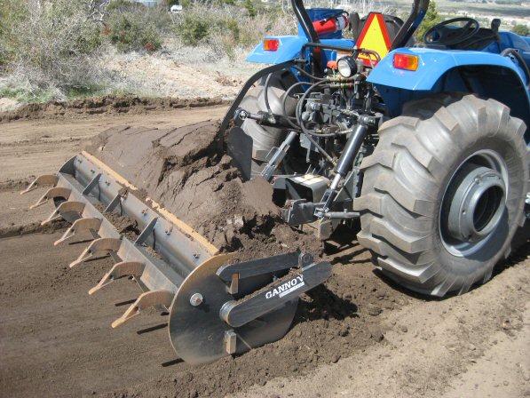

I highly recommend a 65" ROBB (roll over box blade) A little more $$$$, but worth every penny IMO vs a std type box blade. I happen to have 3 of them (ROBB) A 36", 65" & 81" cat 2
The 65" is on the red tractor, basically the size of your L3901. A perfect fit IMO.(y)
