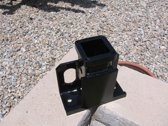

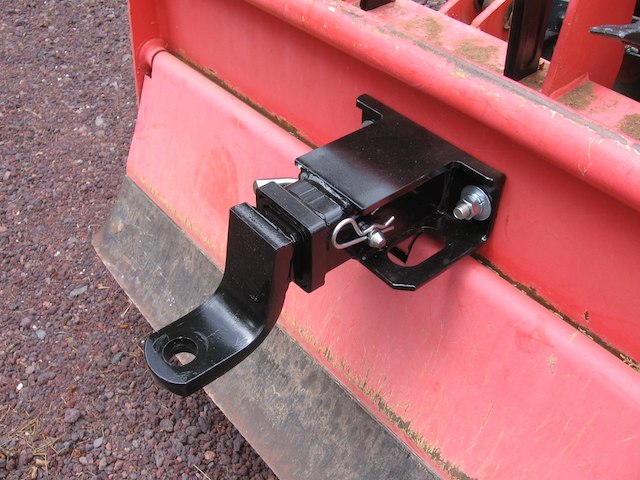

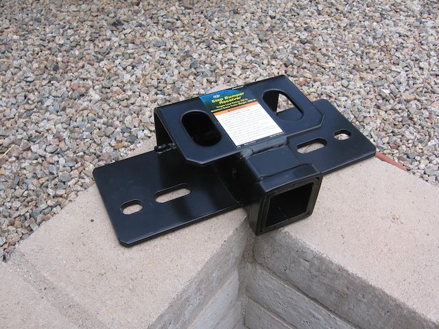

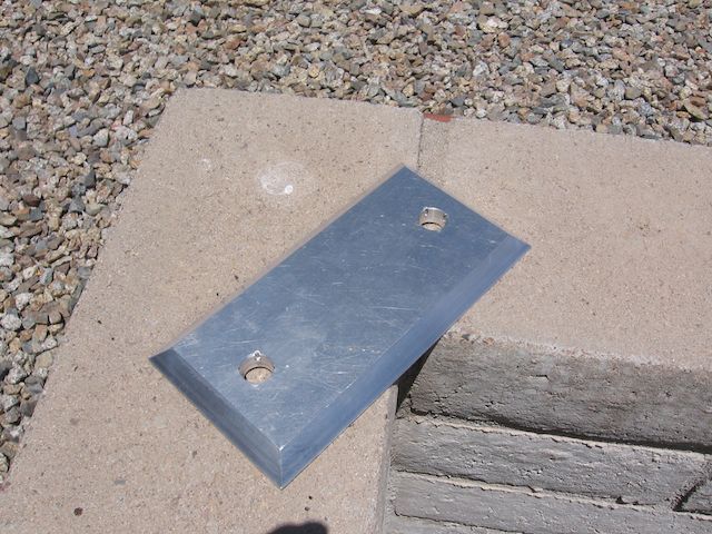

I've been looking for an easy way to add a 2" receiver to my Gannon to pull stuff with either a 1" pin or a ball hitch. I ran across this step bumper hitch at Harbor Freight. (pic #1) With sale price & coupon, it was $16. Machined a lot of the large flange away & drilled a couple of 1/2" holes for mounting. (pic#2) Made a backing plate, beveled the edges so it wouldn't resist the flow of dirt or trap any on the top edge. (pic#3)

These next pics show it mounted. I shortened the "stinger" in this case, but it will take any standard two-incher.
