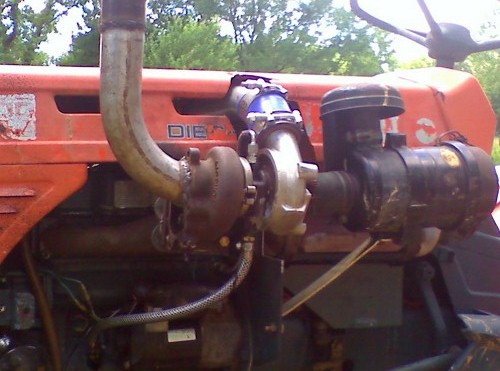

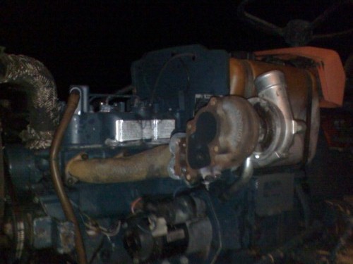

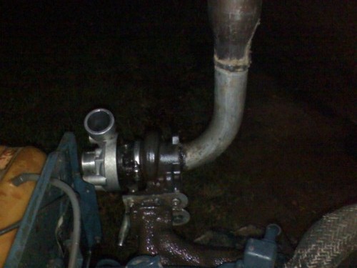

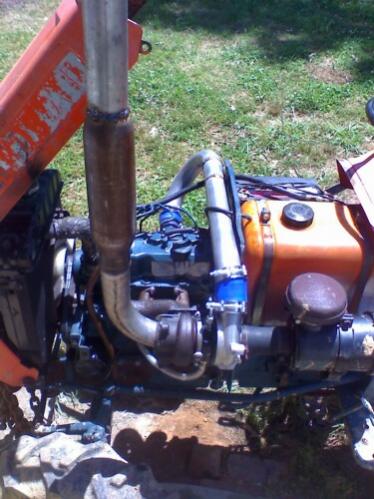

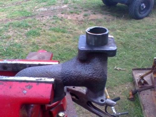

thank to a lil help from tony (boosted b7100) i finally finished my turbo on my b6100. it was so much easier than i was expecting. i did it in about 4 hours on my back porch in the dark with a stick welder, some scrap steel and a sawzall. and general hand tools. i was given the charger for free for some side work i did, the exhaust manifold was completely rotten so for 30 bucks a found a good used one. the rest of the build cost about 75 bucks for various fittings and hoses. im very pleased with the results!. i dont know how much boost it makes, but the charger is a lil big for tiny 3 popper. so if it makes 5psi id be gitty as a school girl. pics coming soon........

and thats the end of the pics. i for got to take pics of a few of the fab steps, i got caught up in working. enjoy!

Have any idea what the turbo originally came off of???

i believe it could have come off a smaller bobcat skidsteer. but im not real sure. it has no markings or tags

the performance is awsome. i dont have a gauge on it so im sure what kinda boost it makes but it kaint be much. its deffinetly a noticeable differance!

Haven't been on here in a while. Man that turned out nice! Great job man! Did you turn up the injection pump at all?

Like it you put a lot of work in it and you can tell by the pictures before and after let us know how it does on the power side when you get a bush hog on it etc. Thanks again for the pics and congrads.;)handy
