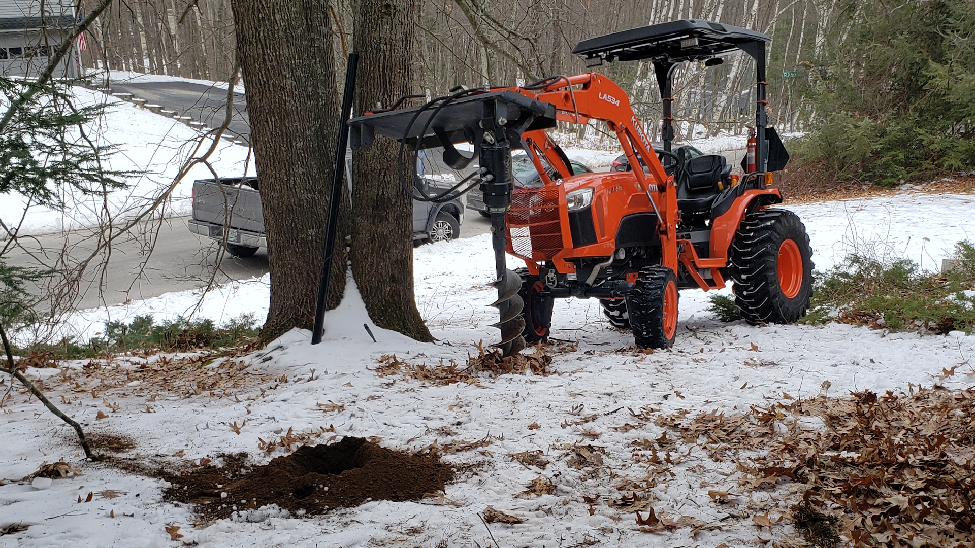

They have changed the model numbers around - mine is an 11-1300. This came out of the mini excavator lineup.
I made the mount myself for a couple reasons. I wanted to be able to mount the drill on the top right or top left (top left gets used most of the time) for better visuals and reach. And I wanted to turn a cement mixer with the same auger motor.
I have thousands of holes with this setup and like it a lot. It isn't magic, we have a lot of rocks up here and it doesn't go through all of them, but between the reverse and downforce, it runs circles around the 3ppt pto style.
Excellent setup you have there and great work on the SSQA frame. I have a 5 cu.ft. 10hp Honda driven concrete mixer so don't need that feature. I have no interest in a 3-point system for a number of reasons but have been looking at SSQA models since last February. It looks like one of the low flow skidsteer auger drives or mini loader drives would be good.

@NHSleddog, it looks like you have four way swing on your setup .... is that correct? I'd want that feature.
Yes is spins in any direction with gravity pulling it down plum. I can also use the cradle to "force" the direction.
