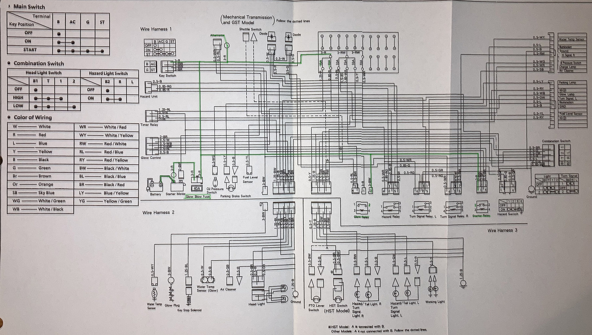

You will have some work cut out for you to further investigate. Locating faults is painfully unfun. I suggest a case of beer to assist you!
Please see attached L3010 wire system schematic. I've highlight your first checks that need to be made in green. You'll have to isolate these components and test wiring to make sure there are no faults. If none are found, then I can highlight all the "load side" wiring that needs to be looked at. I'd start testing with the starter/selonid first, then move on. Also, there could be an issue with your starter, starter relay, and glow plug relay. I wish you luck my friend.....
Thank you I’ll try this next
