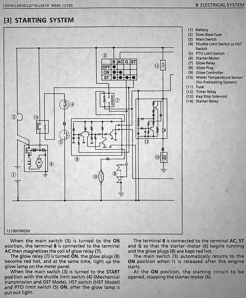

Attached is the starting circuit wiring diagram. It appears when the key is turned to the "start" position, it energizes two things: the starter relay and the glow plug controller. I'd be leaning more toward the starter relay and wiring than the glow controller. The glow controller is also energized during the "ON" position of the starter switch, so you would think the fuse would clear then.
