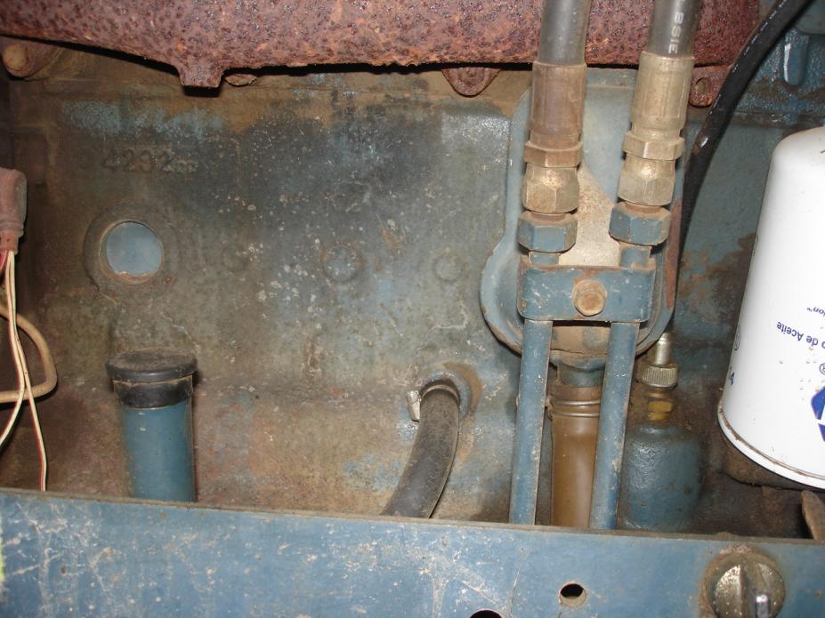

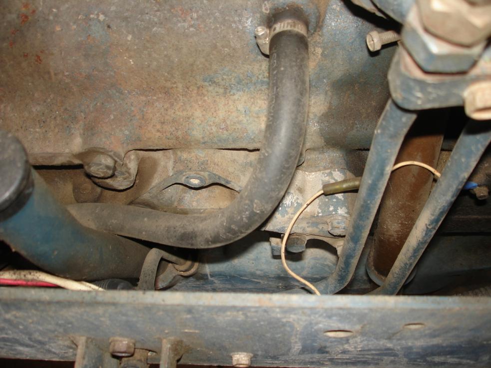

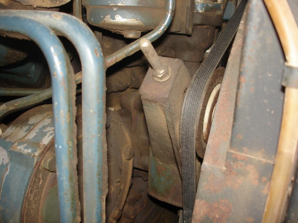

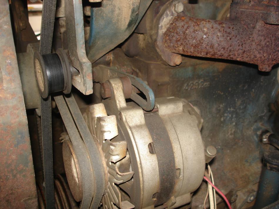

Ok I ordered the frost plug heat that wolfman linked, but can't find where to install it. The plug is only threaded, when I looked it up on the Kat's website it says install in front.
I'm not sure if I'm missing something but it can't go in the front with the moving belts, is it possible the frost plug is threaded??

Take me a couple pics, right, left, right front, left front and I'll try and point it out, sometimes it requires a tee install form a sensor hole.
33,596
8,832
No not the oil pan, it goes into the water jacket of the motor.
Sadly it doesn't look like you have the 3/4" threaded plug on yours, but I can't see the top where the top radiator hose comes from the motor, that's where mine fit on my D950.
I think your going to have to measure your freeze plugs on the side of the block and see what size they are.
