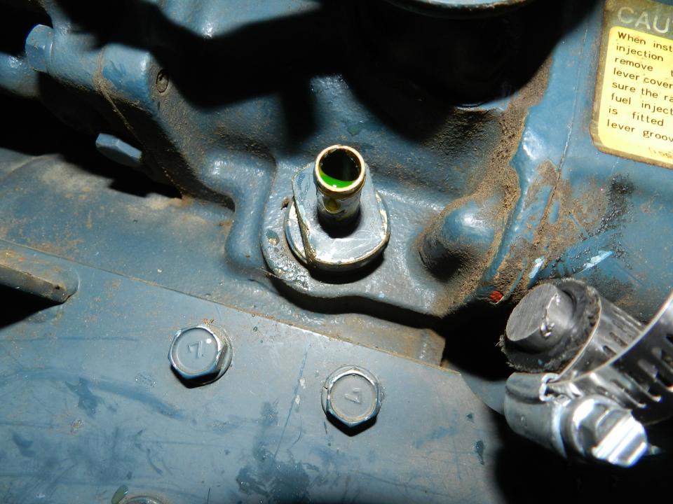

I'm trying to remove the engine plug on my '85 B8200 to install the block heater . I was able to move it about a 1/4 of a turn , but now the tolerances are tight to turn it any more . Has anyone else dealt with this ? the flats are 15/16" wide and the plug is 1 3/8 " OD. Thanks in advance

Yes double sure . I talked to two Kubota parts guys . This is the heater sold to me from one of them . It was verified on a parts diagram by both . Ideas anyone ?

What part and type of block heater did you get?
Is it the 3/4" screw in type?
Are you going to tee off of this fitting?
The threads on the fitting could be BSP threads, not NPT threads.
Ok now that that is out of the way, If you really want it out and don't need to save it heat it with a torch, it's brass it will come right out.
If your short on a torch then use a under sink pipe wrench to grab it.
If you want to keep it in good shape, get a socket or pipe that fits over the fitting, cut the 2 sides to match the flats, then weld two flats plates on it to make a driver to remove it.

I opt for option # 3 . I had kinda thought I'd cut a 15/16 open end wrench ,end off ,and weld it to a bigger socket with a 1/2 drive . Just hoping there was an easier way. Thanks
33,931
9,144
They sell a wrench for just such a thing, called a crows feet.;)

Yes , now I remember I have used one of these in the past . Thanks for jogging my memory !.
