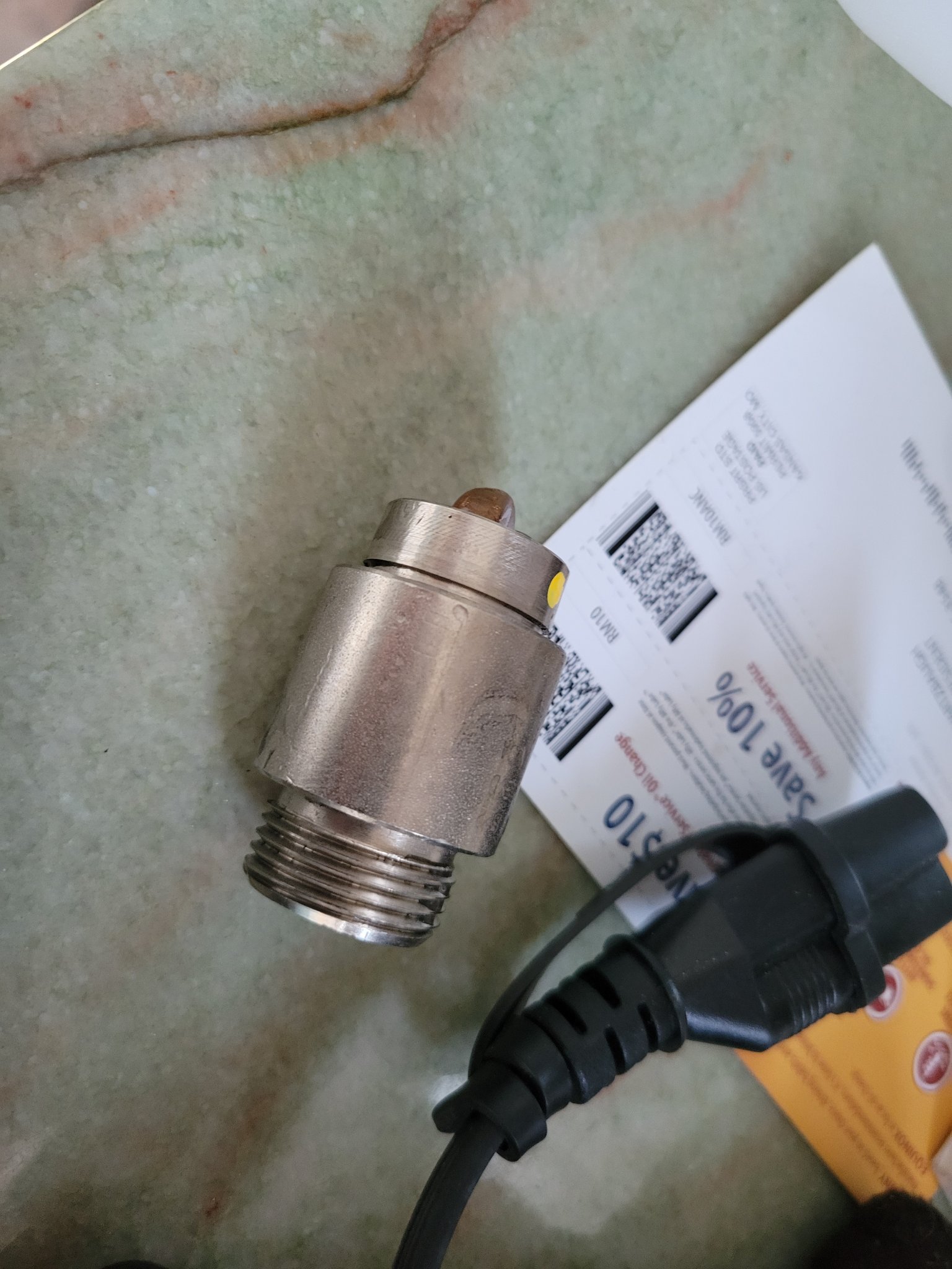

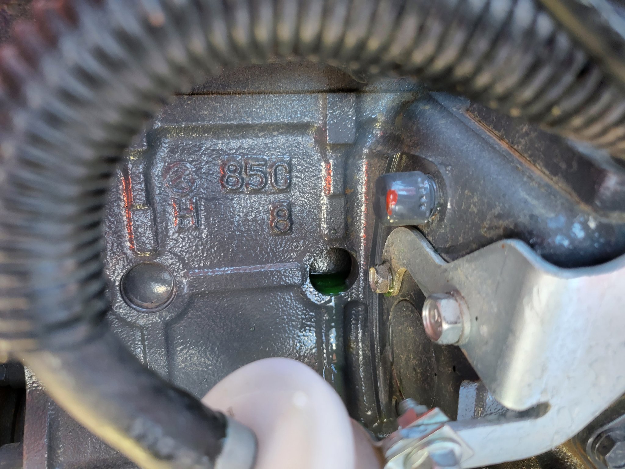

I have a kubota 1880 and I've been looking everywhere to find some video or info on how to install a block heater on my tractor. I couldn't find anything specific to my tractor but I found a bunch from others. In the video I found it shows the guy knocking out one of the tabs on the side of the engine that look exactly like the image I attached. He then tapped his block heater into the tab. As soon as I knocked out the tab green fluid flooded out. On top of that the block heater I bought doesn't even fit the whole. How screwed am I? Is there some product that will fill in this whole that I just created in my engine? Is this the correct place to place a block heater? Please help. I've got a ton of snow to remove and a non functioning tractor.

It's called a freeze out plug. Measure the HOLE and tap a new one in using some sealant. It appears that the bolt head will interfere with the block heater at that location. The green liquid is anti-freeze, you need to replace what you lost before operating the tractor. The block heater you show is a threaded in type, I don't know if you have a threaded port in your engine. An auto parts store might have a freeze out plug.

Thank you so much lynnmor. The tap that is to the left of the one I knocked out, is that where I would put the block heater if I had one that fit?

The block heater must be specific (size) to the tractor you have. Typically there is an interference fit adapter that is tapped in place of the freeze plug that has been removed. Then the block heater screws into the adapter. The location of the freeze plug you removed would not likely allow room to install a block heater, so it will need to be replaced and a more suitable location selected.
You can not operate your tractor as it sits, so have a mobile mechanic come out, install a new freeze plug, install the correct block heater and refill your cooling system with antifreeze. IF the level of antifreeze drops below the block heater, it will quickly burn out the element.

Thank you all. I am going to do as was suggested and have someone come out to fix the original problem and the new one I caused. Much appreciated.
