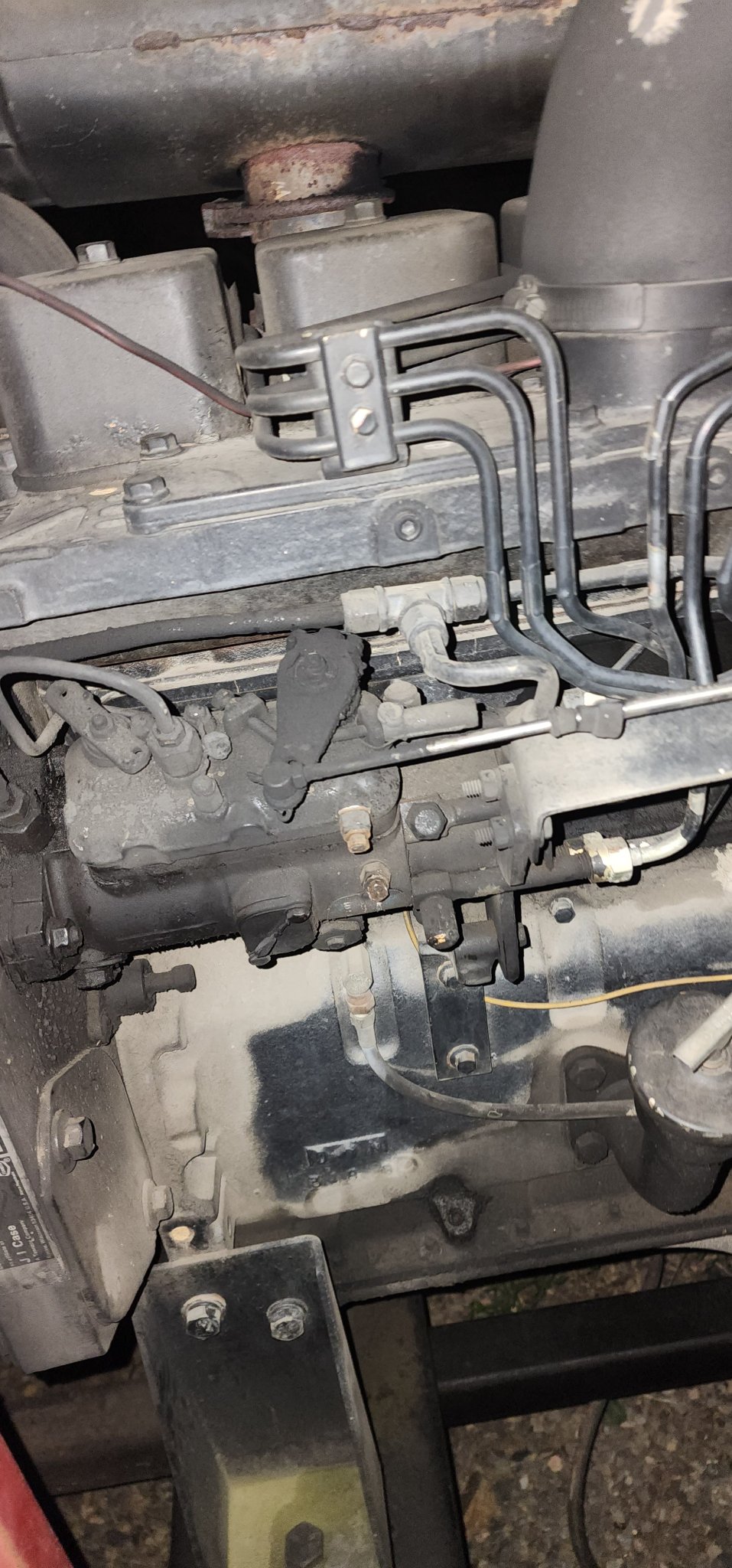

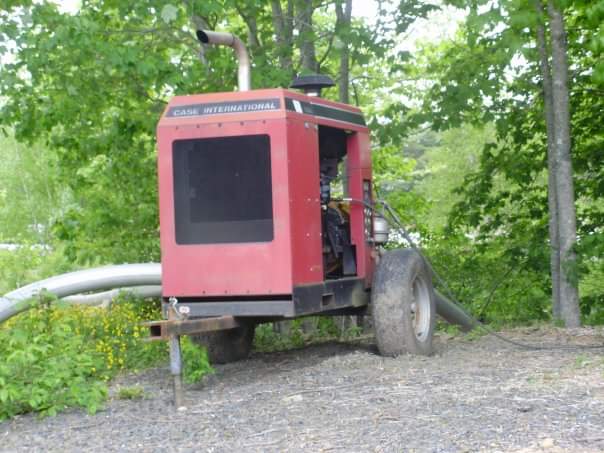

So one of my older engines that's on a water pump, (International engine this time not the perkins one) has an extremely hard to bleed fuel pump if it's ran out of fuel. It's a stationary pump so this does happen from time to time if I forget to check it.
I tried many things to bleed it but finally found one that works good. So you start by taking out the bleeder screws and using air pressure in the tank to pressurize the fuel. Once you get fuel at the bleeders and close them you unfortunately aren't done......
The design of this one if you crack an injector line it let's air back in so you are stuck rolling it over for like 10 mins. So a min or 2 every time you go by until it starts.
I tried using ether to bump it and hope the RPM got it to bleed but it didn't and I didn't want to just feed it either until it ran on it's own.
So basically I decided to use wd40 directly into the intake pipe and just feed it that slowly, it's a lubricant and it burns well so I figured it would be better than ether.
So I did that and after running on wd40 for about a minute or so it finally took and ran on it's own fuel pump.
My curiosity Is would this be bad for some reason? Something about wd40 that I'm not thinking of?
Also why on earth is this one engines injection pump so hard to bleed? At one time or another over the years I have had to bleed every engine we have and the worst I had to do was loosen an injector line for a second. Generally it's just fuel to the bleed screws and away you go. So why is this one such a nightmare?

Have you tries bleeding the injector lines while the tank is pressurized?
Open the throttle all the way, and turn the engine over slowly until you get each line bled.
Just curious, what IH engine is it?
I think the engine is a Cummins but I can't remember I'll have to look again. I tried many ways to bleed it, very stubborn. I didn't trying cracking the injector line while having high pressure in the tank... could be worth a try.

So when you bleed it, do you start at the filter, then bleed the pump at the lower bleed screw before cracking injector lines and using the starter? Looks to me it should be pretty straight forward and by no means all that hard to start.
Shadow_storm56
Lawn mower
Oct 22, 2020
527
Yup literally the same way I always bleed them. Just never bleeds properly.... fuel coming out all the bleed screws isn't enough
