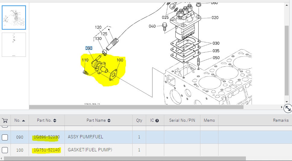

My first thought sounds like you have a failed lift pump.
Other option would be a bad gasket on the fuel filter housing or a crack / break / leak in a fuel line.
