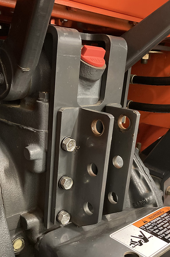

Your backhoe might be too old for one of the new style mounts, but you can try calling the dealer to find out. I will say that it looks like you're missing the recommended top-link reinforcement bracket....
looks to me that he does have the heavy duty top link bracket. I lightened up the picture a little bit. it appears to be exactly the same as mine.
edit: BUT I forgot that the OP has an L 3400. Mine is a B series. I’ll try to add a second photo here that shows what the heavy duty top link brackets look like for the B series and perhaps the OP can compare what he has.
6,106
3,396
VERY risky to use a 3PH backhoe without a heavy duty top link bracket. Can’t be stated too many times…

Here is the reinforcement bracket that is currently on my L3010:
