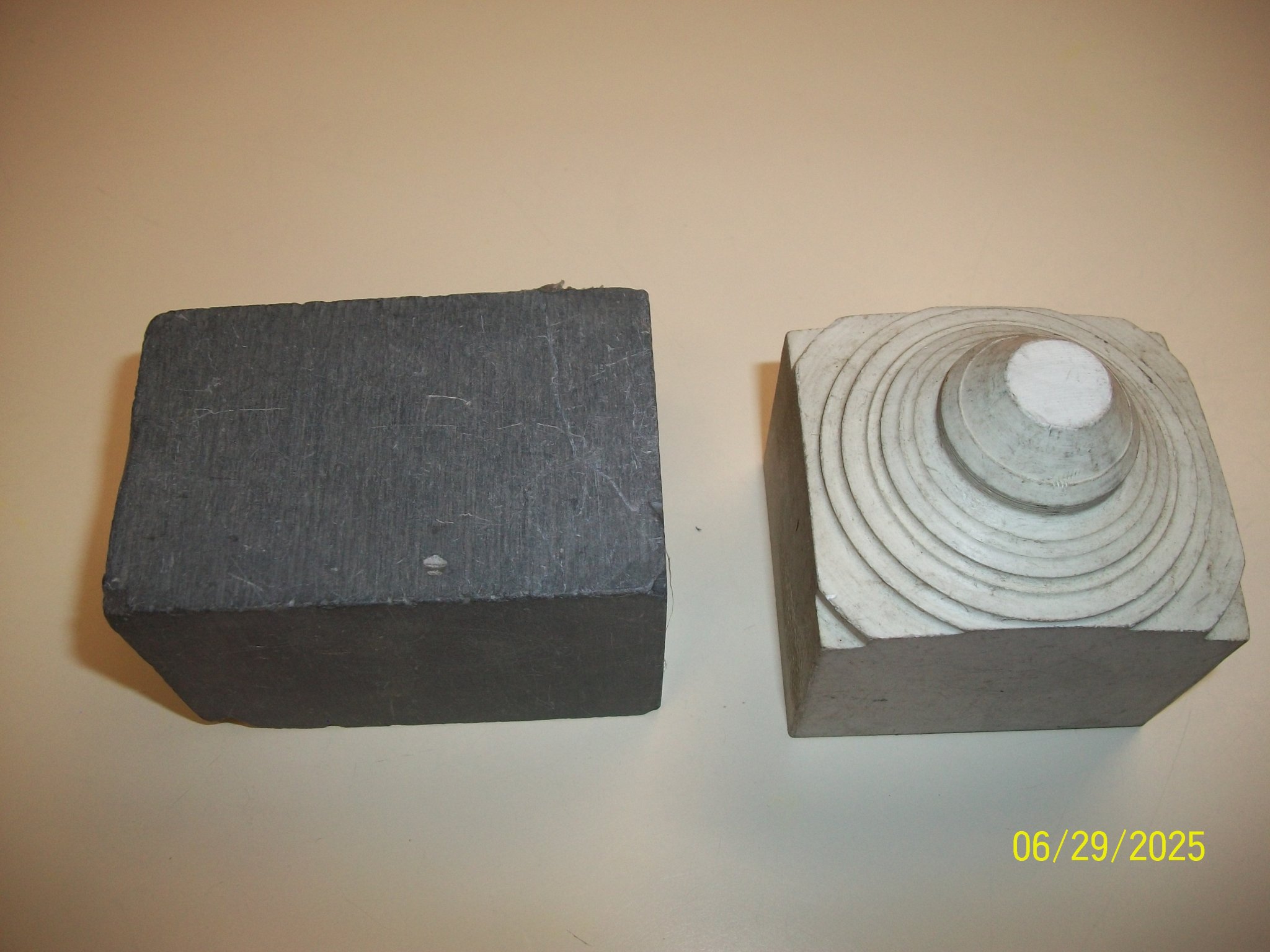

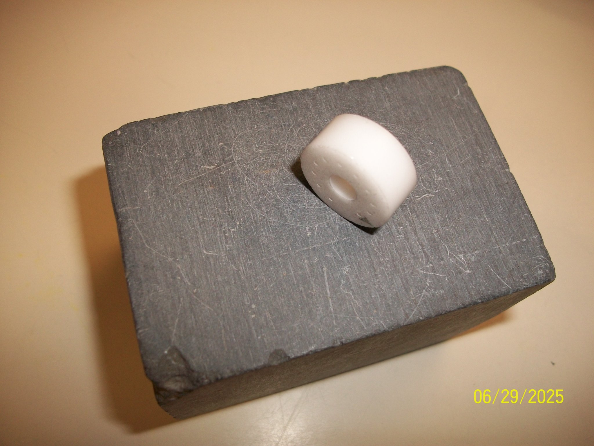

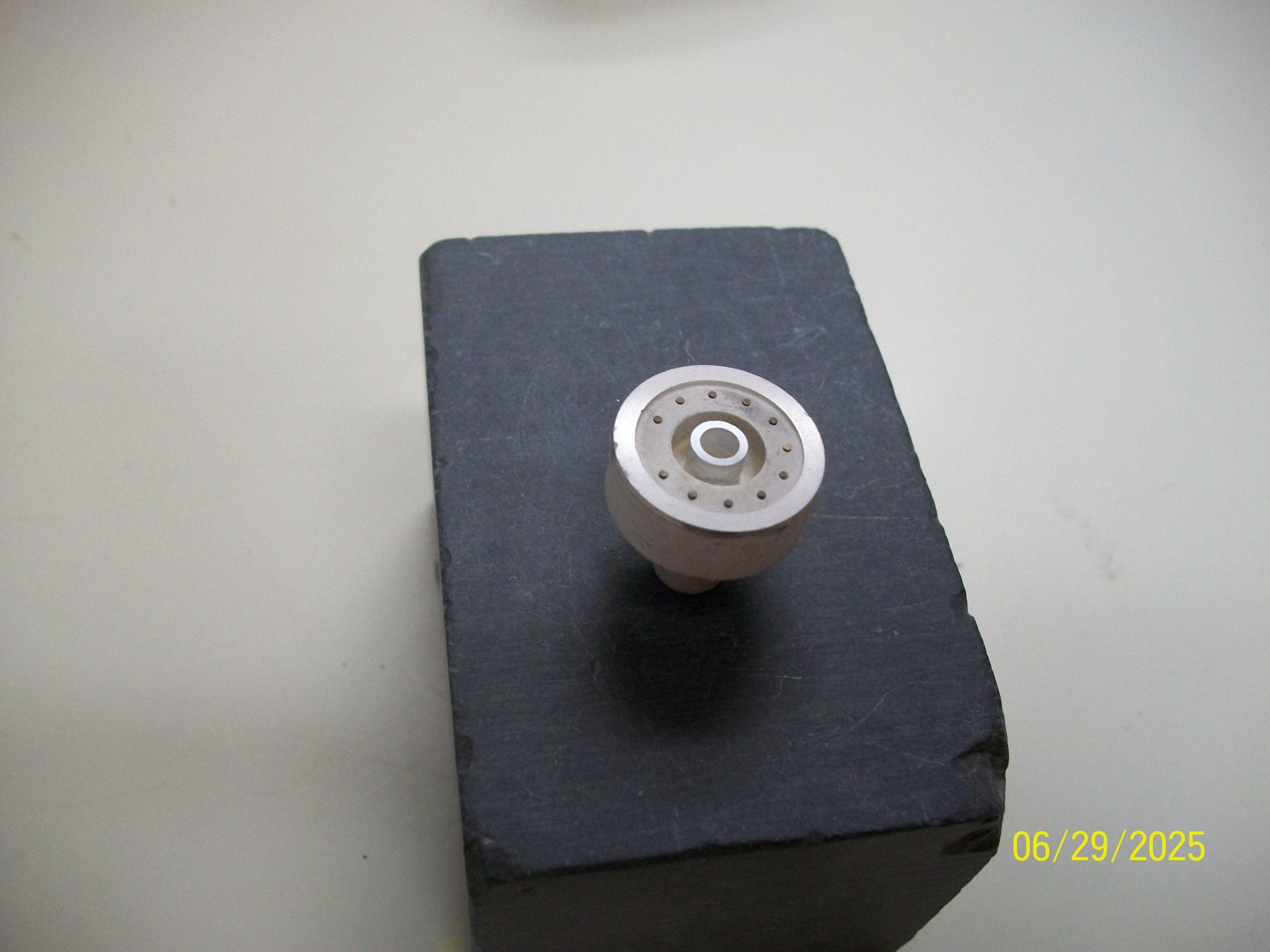

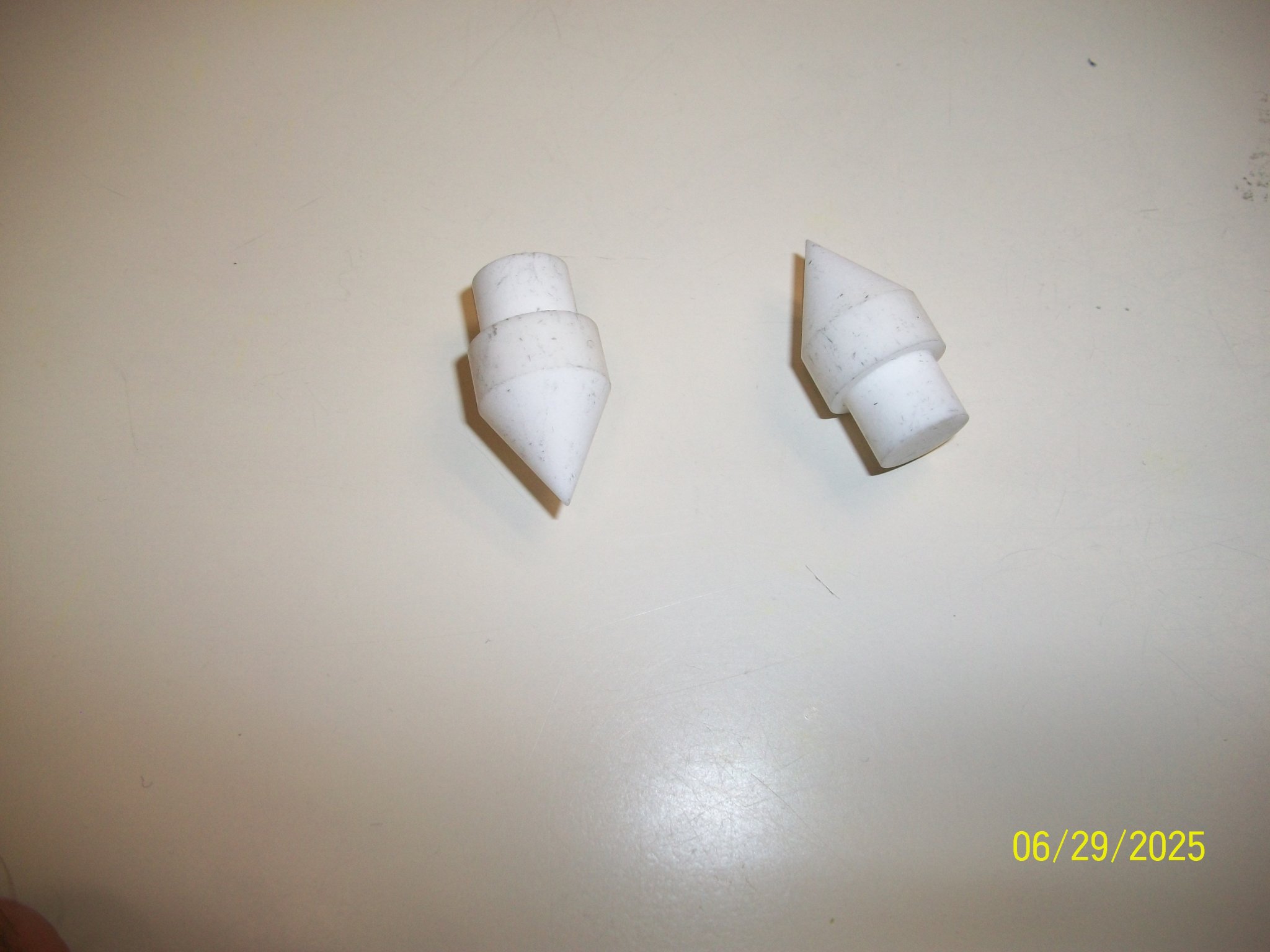

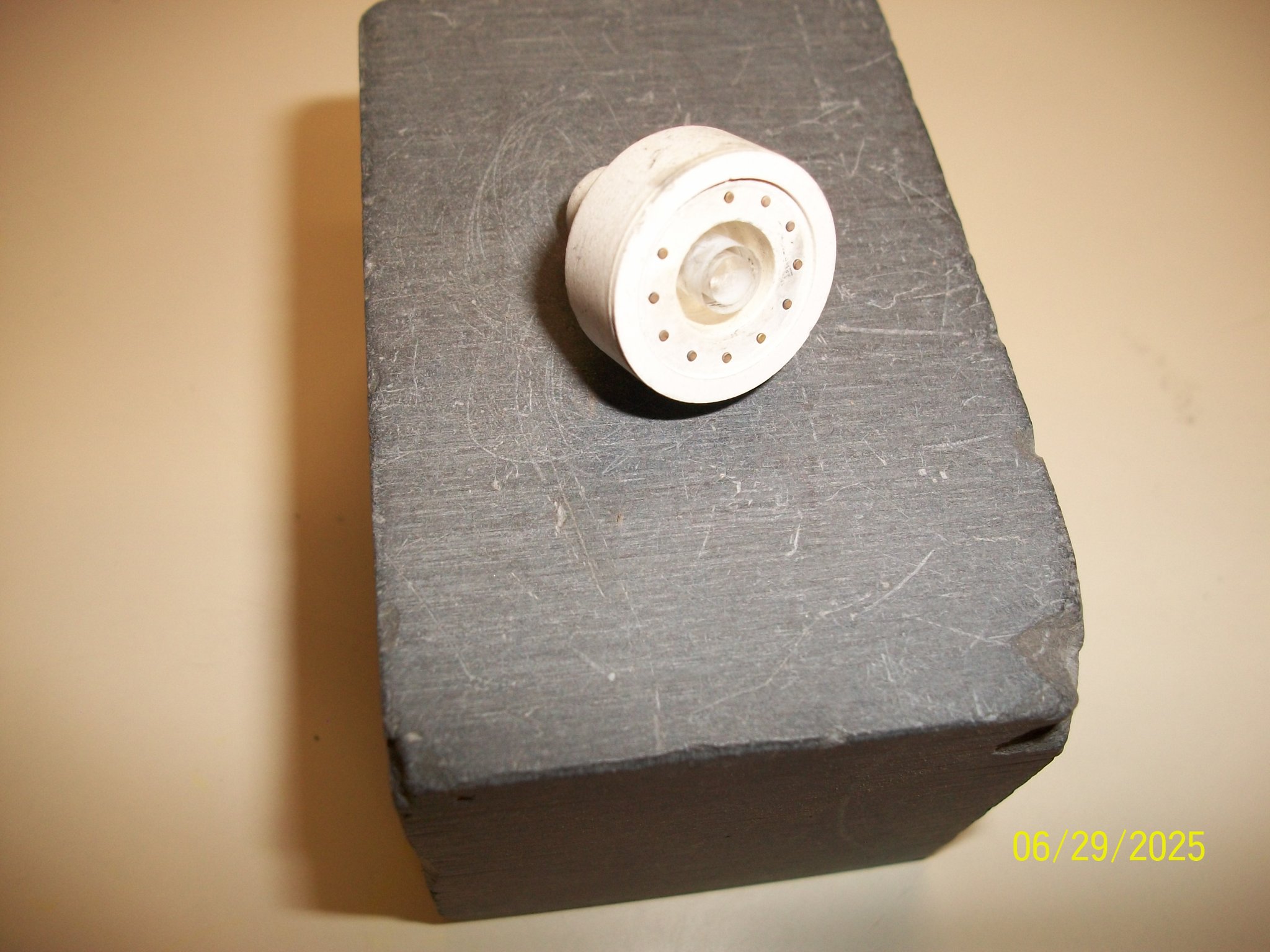

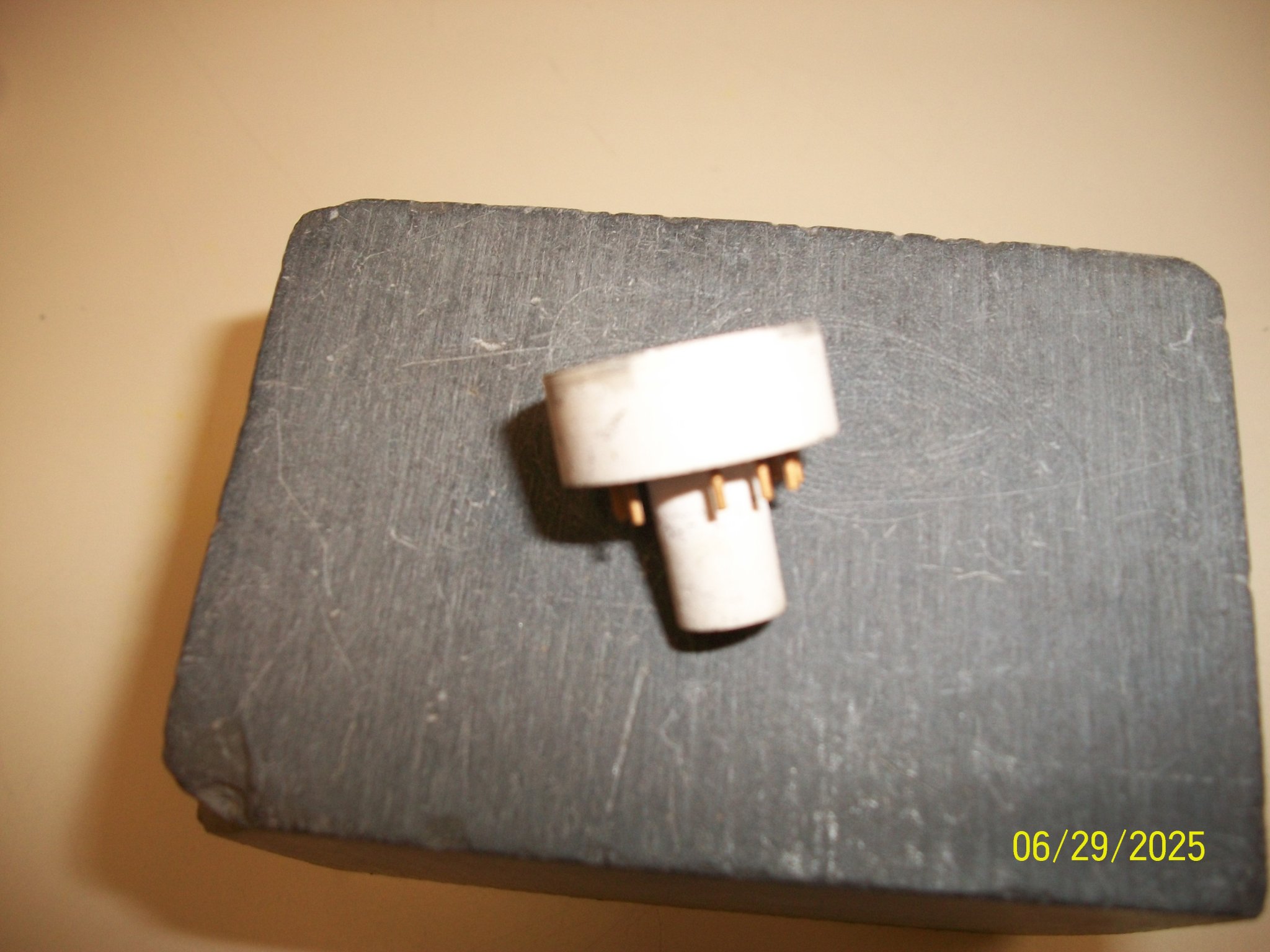

Pictured below are a couple of chunks from the stash, I have more, but it was buried & 115F outside where the shed is.
The rest are old parts that have been rattling around in a junk drawer for years.
The pointy parts were made to eliminate heat sinking from a fixture to the base plate of a vacuum system.
Fixture stood on the points of three of these.
As you can imagine, not much heat transfer from the fixture. thru the points, and into the base.
These are Macor, the best machinable ceramic I found.
The others were prototypes for a case/mount for a sensor chip, that was direct contact bonded to the center glass tube, micro wires welded from the chip to the pins, then a cover direct contact bonded to the case/mount.
Not a material you need often, but when you do.....
