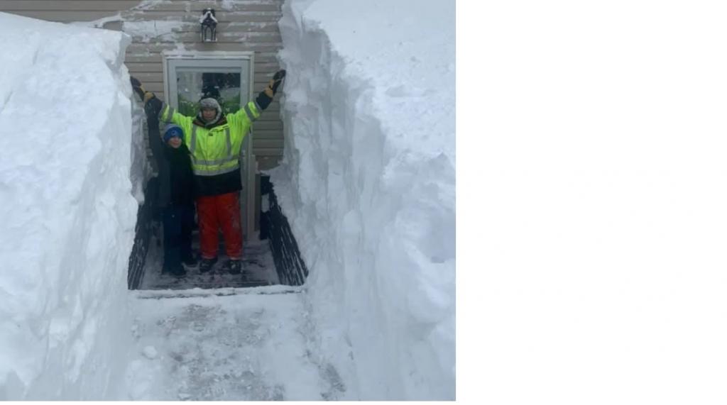

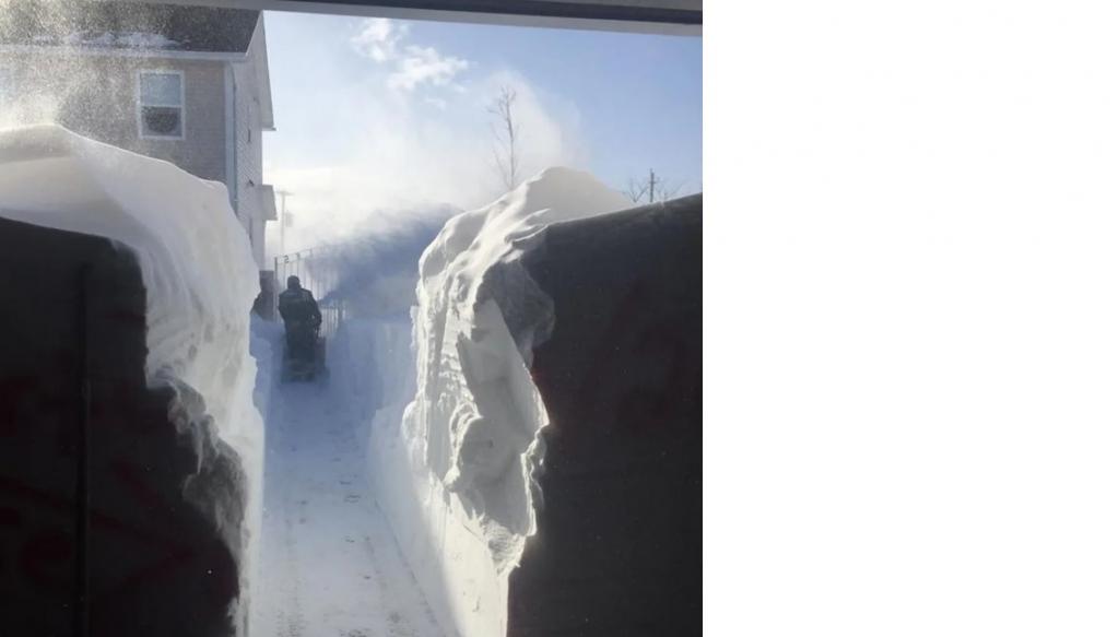

Some pic's of the snowstorm ending today in Eastern Newfoundland Canada..... thank god for shovels !!
