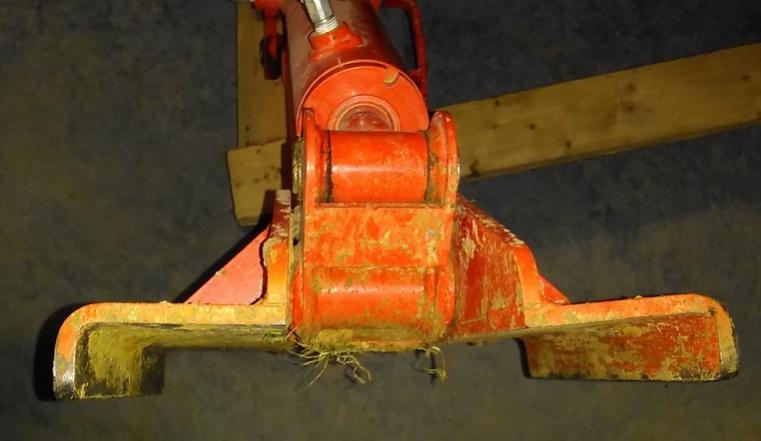

I noticed when I took the BH77 off the tractor that one of the stabilizer pads was bent and I think I might have done it when I was digging the trench the other day. I was connecting the two parts of the trench and was digging at 90 degrees to the back of the tractor I might have caught the pad with the bucket tooth. The pad was covered with dirt, so I didn't notice how close I was. I wouldn't have thought you could have done this.
Has anyone else done this and if you have how did you bend it back?

Did you bend the pad itself or did you bend the leg? A picture may help. Does the pad still pivot back and forth easily?

I have had the exact same pad on my 76 actually break...not sure how. I bent the unbroken part back by setting the un bent part down on a block of wood...pounded the bent part back with a 3 pound sledge...carefully. Welded it back up with a stiffener piece as well. No problems since.
They are not built too sturdy to start with

Bar clamp or large 'C' clamp, gas axe and a spray paint can to renew the finish will work peachy. Think I'd install rubber street pads on the bottom side and be done with it.

Like tarmstrong suggested, if it were me, I'd flip the pad over, use 2 blocks of wood and put the weight of the tractor on it and then use a sledge to beat it back into shape. I can't tell for sure from the picture but it looks like it is spread some too so a large C clamp could be used for that, preferably at the same time if possible.
