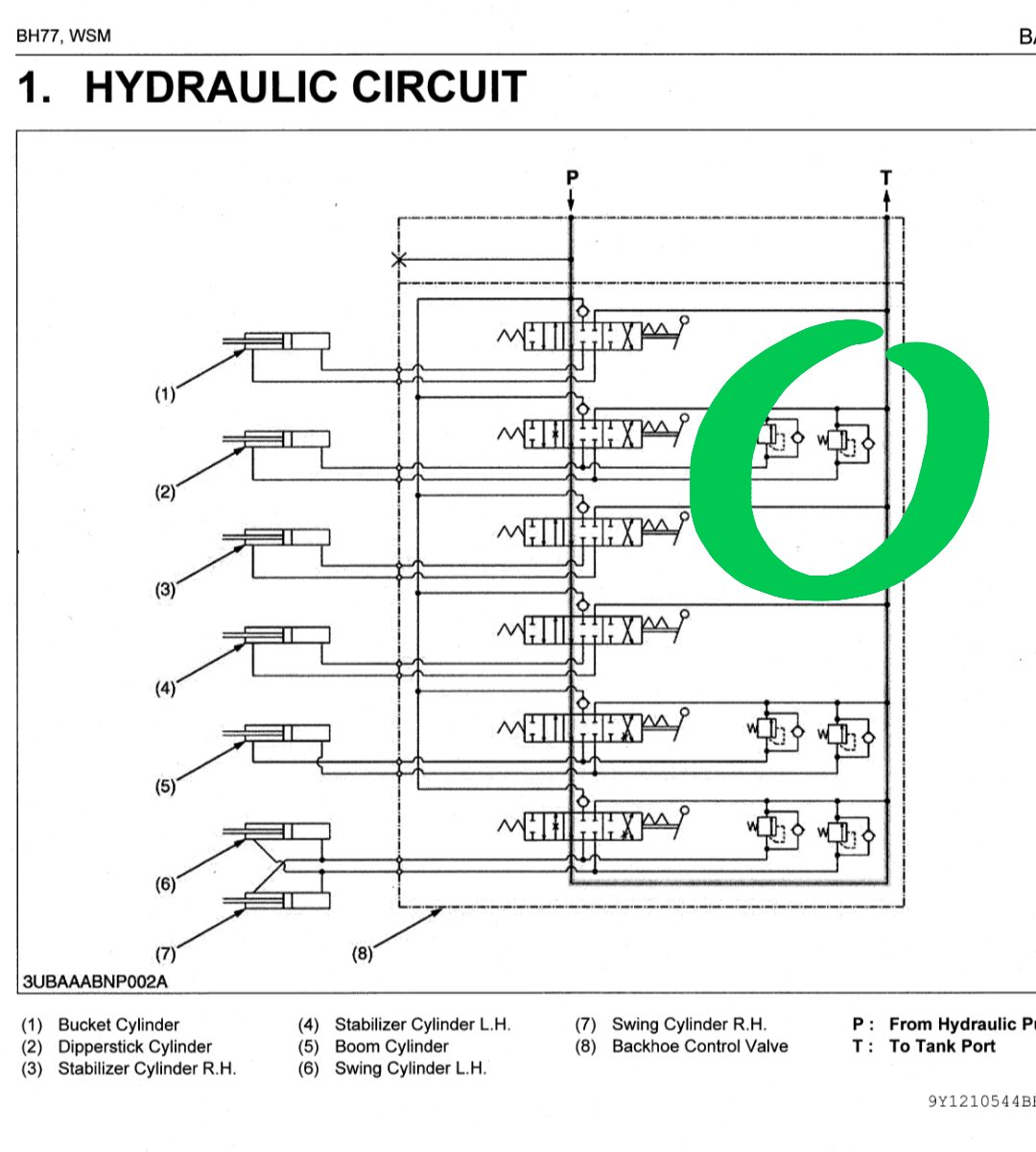

There is a free WorkShop Manual download for the BH77 available at KubotaBooks.
The hydraulic diagram shows these overload reliefs on the dipper circuit. If one is opening too early, it would cause the problem. The setting could be measured by installing a pressure gauge on the line to each end of the dipper cylinder. A quick perusal of the WSM didn't reveal the setting, but I'd expect 2000-2500 psi.

I believe the behavior is the result af activating the port relief(s) on the dipper stick valve.
Those reliefs are not "shared" with the bucket but they are there for a reason. They prevent overpressuring the cylinder by the combined forces and shock loads generated by the bucket and boom.
You can monitor the opening pressure by installing a pressure test tee in each of the two hoses going to the dipper stick cylinder. I dont know what the cracking pressure should be but typically its a few hundred PSI greater than max pump pressure. Those relief cartridges are known to fail and they are quite pricey.....

PoTreeBoy showed you the circuit.schematic with the dipper stick port reliefs circled. The squealing is likely on of those reliefs operating due to the cylinder pressure generated by the bucket digging forces.
Thats how it is supposed to work. The only question is what the actual pressure is when the relief opens and if its too low. Ask the dealer if they have tested the port reliefs on the dipper stick and if sobwhat the cracking pressures are. If you want to do it yourself the pressure gauge, a hose, and two test tees with caps should set you back about $100. Way cheaper than dealer rates.

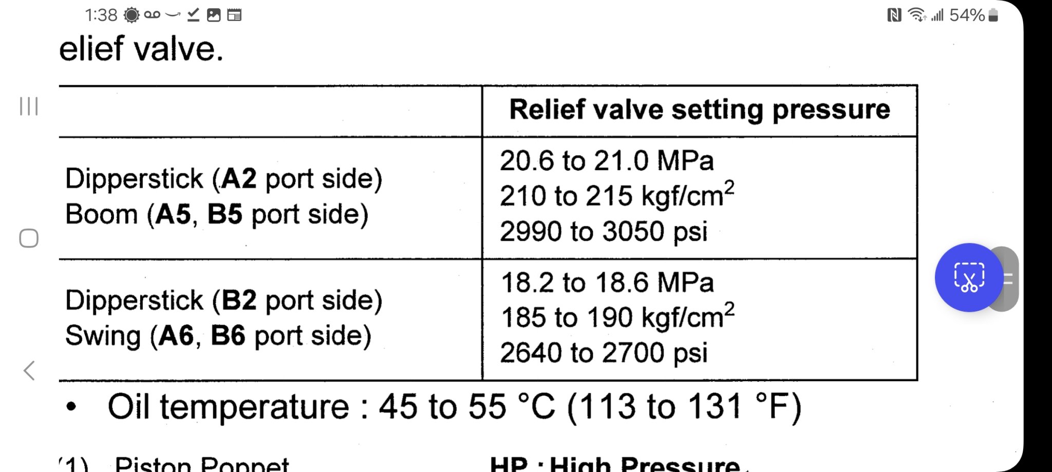

Here are the port relief specifications from the WSM
Dipperstick port A2: 2990 - 3060 PSI
Dipperstick port B2: 2640 - 2700 PSI
if you need new relief cartridges they are $500 each.....
Thanks! I just looked myself and found those pages. Just trying to figure out which relief valve it would be a2 or b2.

The Ax ports are on the stem end (top, I think). The Bx ports are on the end away from the stem.

The troubleshooting section of the WSM mentions "Dust in overload relief valve" as a cause of weak cylinder, and "Flush hydraulic line" as a solution. If, after testing, you determine a relief is opening too soon, you could remove, disassemble and clean, and replace it. If it still opens too soon, the relief pressure can be adjusted to spec.
Or, especially if under warranty, have the dealer do it.
