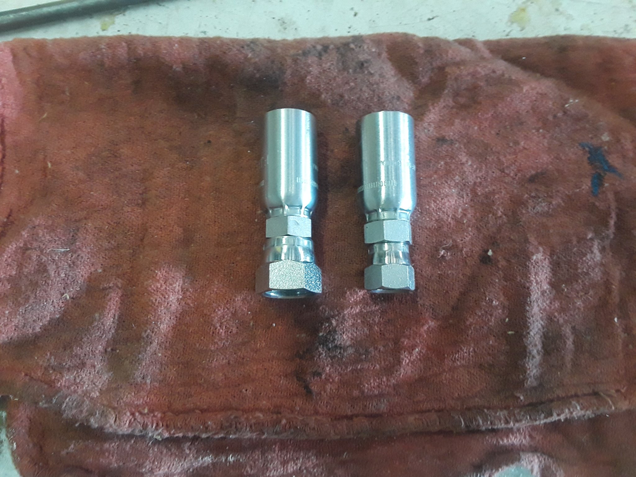

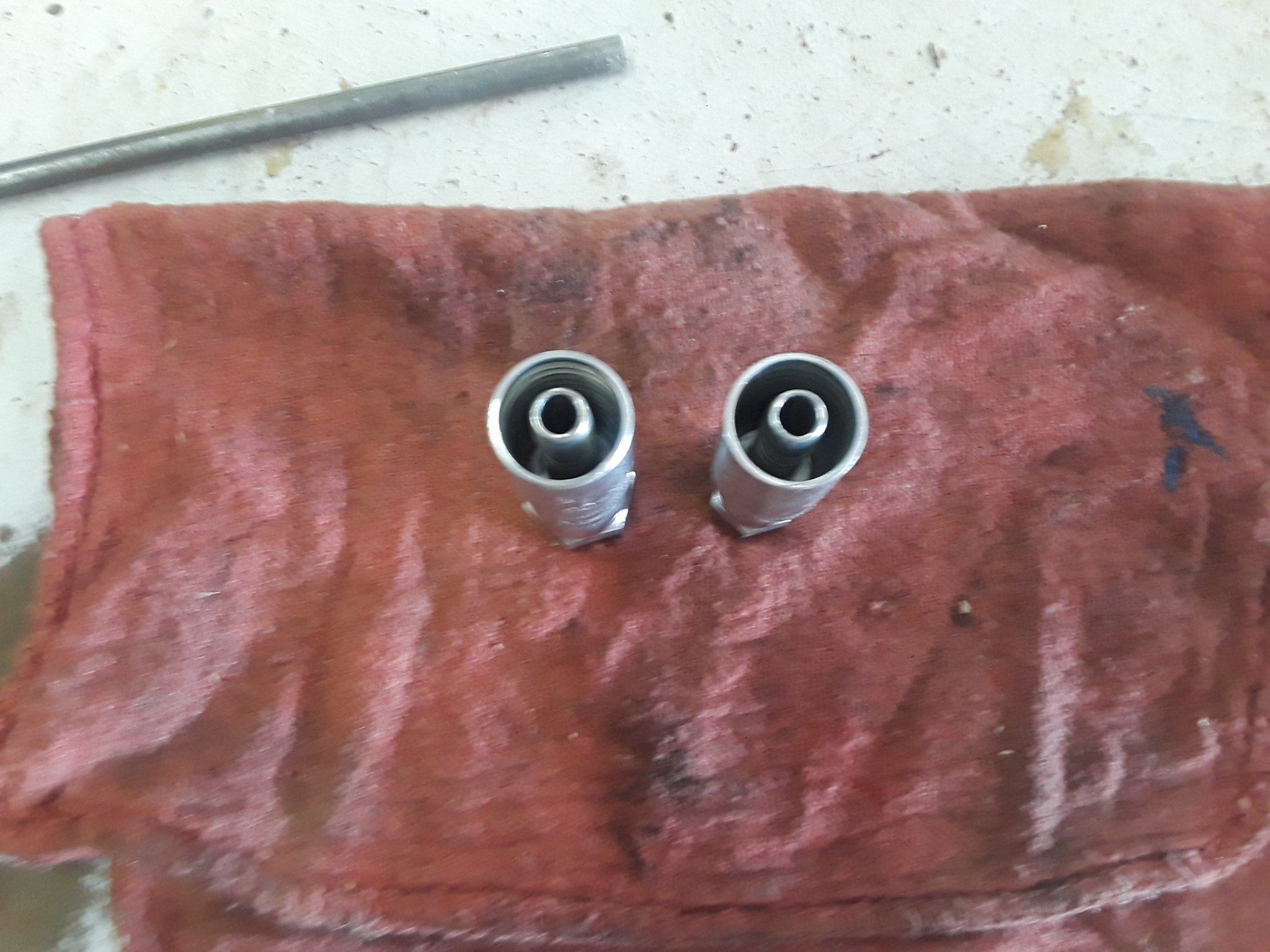

That is correct. Here are two standard 3/8" hose ends. as an example. One has a -08 JIC swivel nut end and the other is a -06 swivel. nut, As you can see in the first picture the -08 nut is larger, The second picture shows the stem end that goes inside the hose, Both stems are the same OD and ID,. The larger swivel does nothing to increase the flow in the hose and simply takes up more space where it connects. The ID of the hose is the governing factor when it comes to the cross sectional flow area. That choice of swivel size can be significant when you are trying to fit 4 hoses into a tight spot on the top of a valve,

I see. And this is a pretty tight area. So, I might be ahead to go with the 4F rather than the 6F. A buddy of mine also advised me to go with female swivel on both ends and adapt to that. I sure do appreciate your help and advise. Us old farts need to stick together. Thanks again. Steve.
