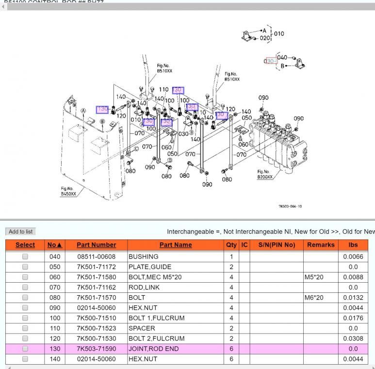

Try pulling the cover off the BH to expose the control lever linkage. Make sure that the lever connections are not bound. There are three bolts that attach the levers to the rod end joints. If they are not aligned correctly, it can cause the valve to not open up enough to get full flow to the cylinder. Simply stated, check the position of all of the control rod connections to see if any are causing binding when you move the control sticks.
These are the little buggers I'm referring to...
I came here to comment on this. The nuts that hold the rod links on came loose and I slowly lost movement in my BH since the rod was moving on the bolts. Eventually one fell off and I noticed when I couldn't move my stick! I took a punch and indented the threads so the nut at least wont come off again.
